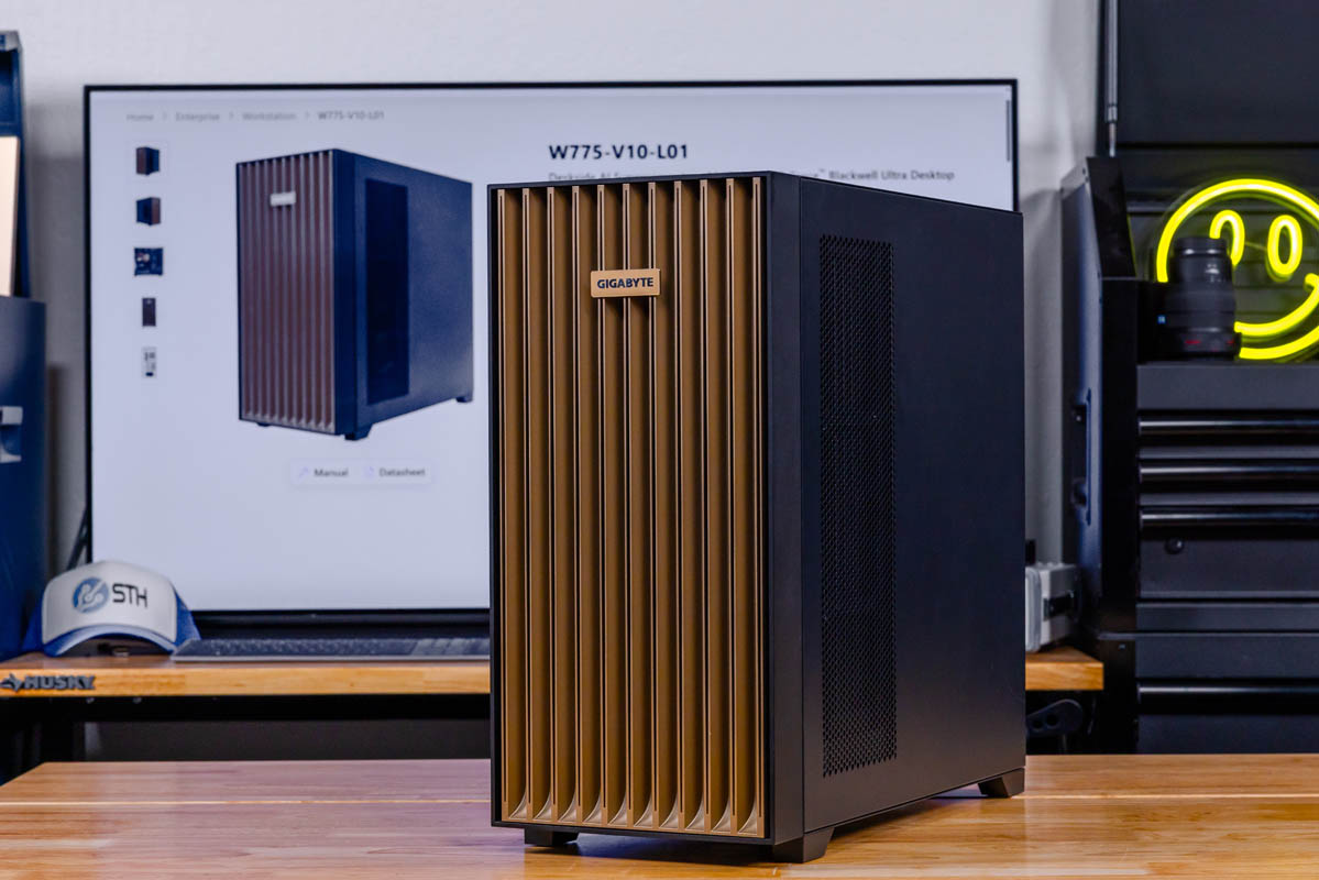

You may want to take a look at this as well:
I can’t even begin to estimate if these “hundred-thousand-dollar workstation[s]” are cost efficient compared to e.g. discrete RTX Pro 5000 cards, so I’ll just leave the link here. :slight_smile:
