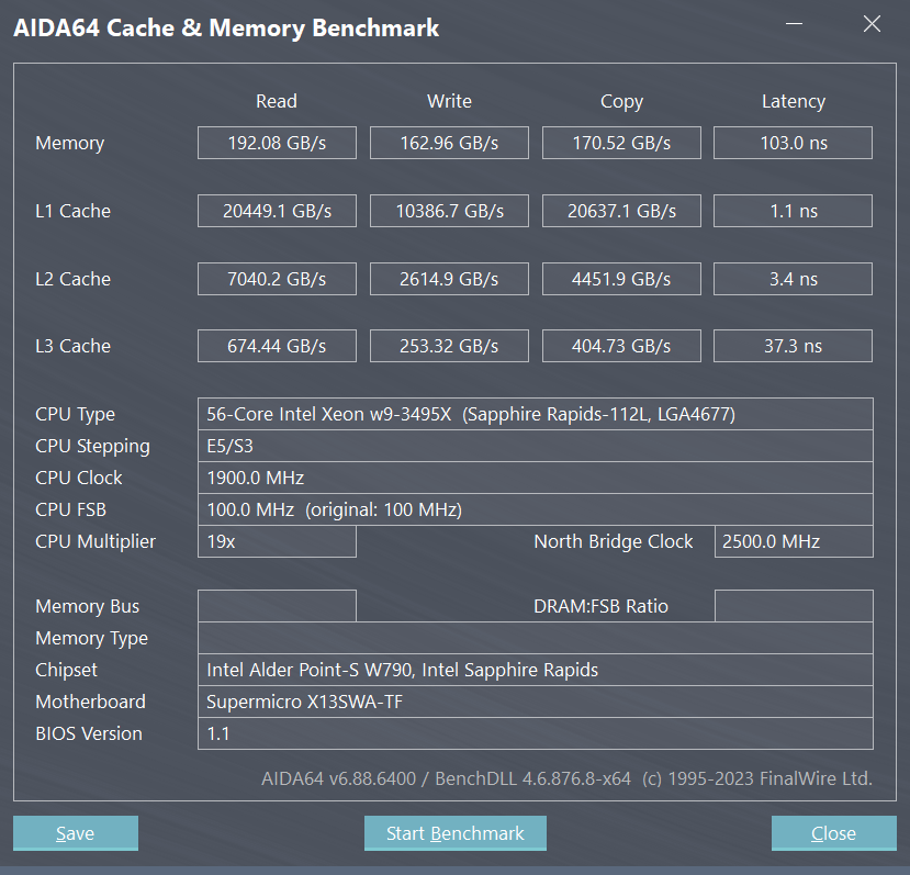

I’m still running on 6x Kingston KSM48R40BD4TMM-64HMR 4800MT/s. My number looks something like this. This is with stock everything. (I’ll have the last 2 sticks sometime this month and will retest then.)
Per-core L1 looks quite slower than your result (569.5 GB/s × 16 cores vs. 365.1 GB/s × 56 cores). I guess this is proportional to the lower CPU clock? I should possibly try running this again next time around with some OC.
