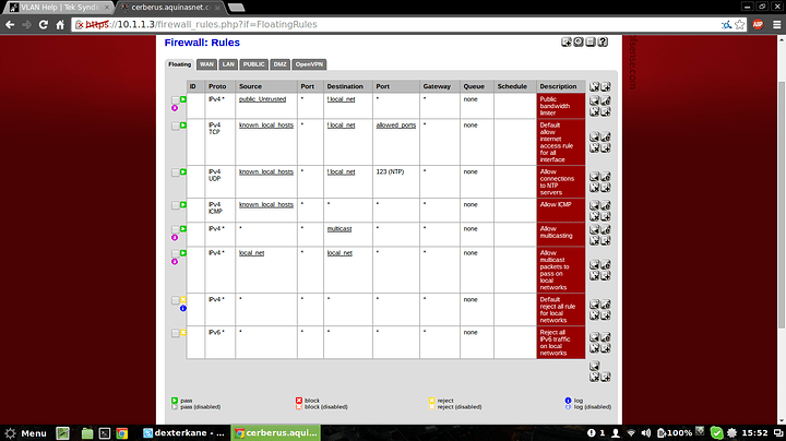

Floating Rule
The floating rules are useful if you want to make a rule which applies to multiple interfaces, like my rule to allow web traffic. You can alos use floating rules to match traffic, so they don't effect whether traffic is blocked or allow but they can be used to change some other aspect of the traffic, like putting it in to a queue for the traffic shaper or applying a bandwidth limit. At the bottom I have a couple of reject any any rules, this is to reject traffic as the default action rather than block. Rejecting is better on your internal network because it sends a message back telling the host that the traffic is rejected, when it's blocked the host will continue resending the message until it gives up which can slow things down. On you WAN interface you want to use block though because it stops someone who is probing your IP from being able to gather any information about you, it will just look like nothing is there.

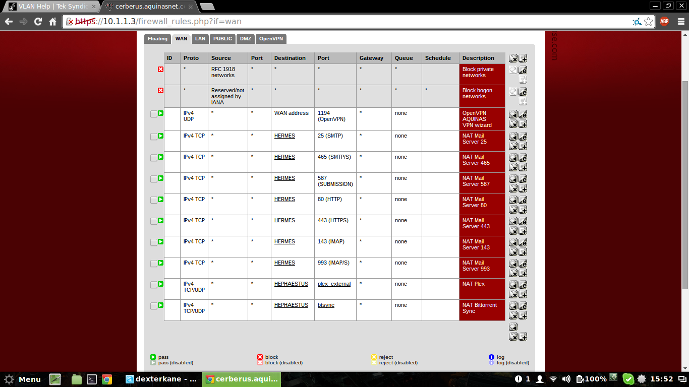

WAN rules
These are all default rules for the port forwards

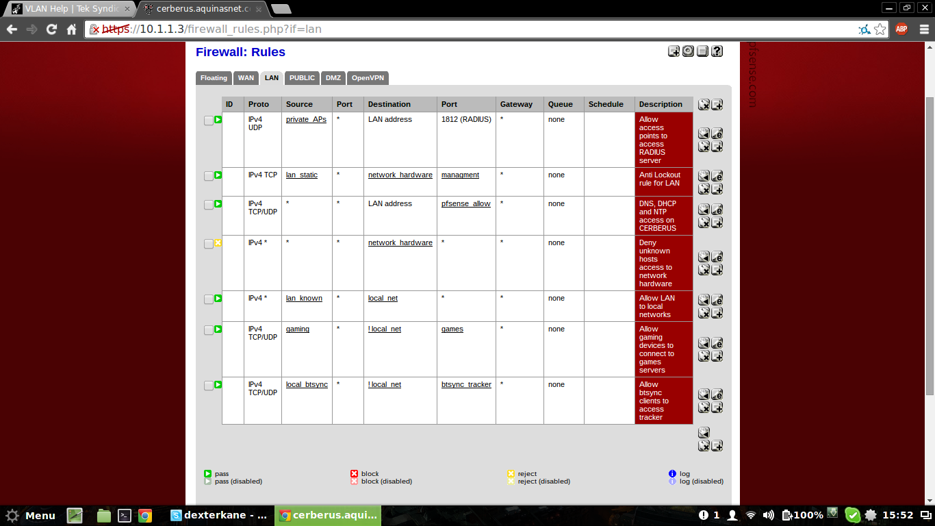

LAN rules
The jist of the LAN rules is to allow the LAN network to access pretty much everything on the local network while limiting the internet traffic to only allowed ports

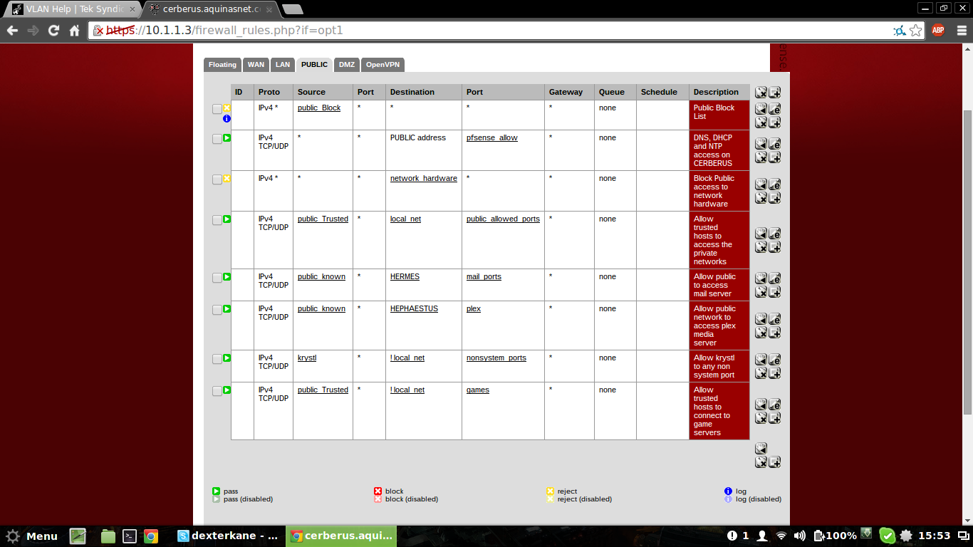

Public rules
The public rules allow people on the public network to access the internet but not access my local network. The exceptions are they can access my local mail server and plex media server and hosts which I put in the the trusted group can access the lan network. This way someone can access files on my NAS without me having to tell them my wifi password.

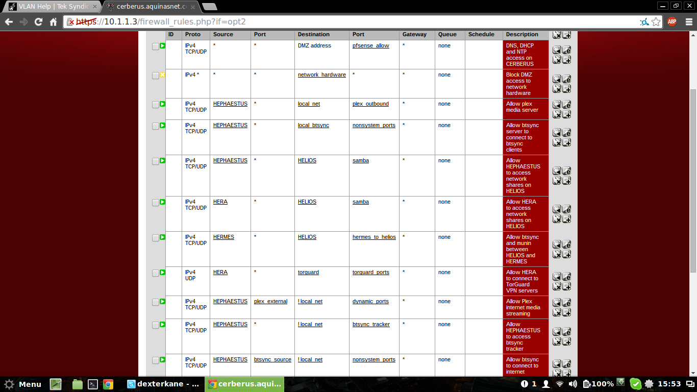

DMZ rules
The DMZ network is used for any web facing hosts, like my mail and web server. The idea is that if someone hacks one of these servers there is another firewall layer between them and my trusted network. The rules here allow very specific access between the DMZ computers and the local networks.

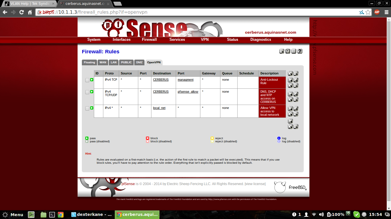

VPN rules
The VPN rules are pretty basic, they just allow a VPN client to access the local network the same as the LAN network.
