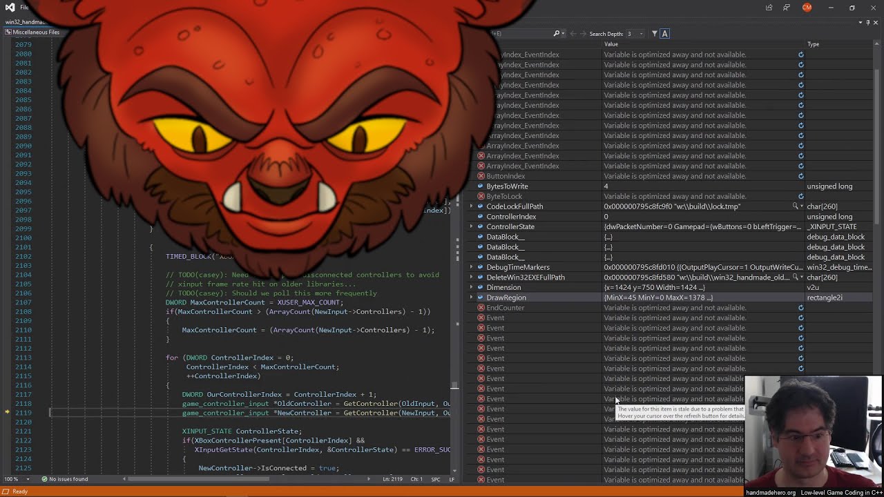

Unfortunately, I think this is systemic to the VS team at microsoft.
If you have some time to spare, this video shows quite a few of these performance and productivity issues:
I find it quite amusing that they broke basic functionality just to have something to justify their jobs. :rofl:
