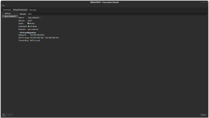

1.) Open up virt-manager and click Edit → Connection Details
2.) Click on the Virtual Networks tab

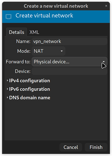

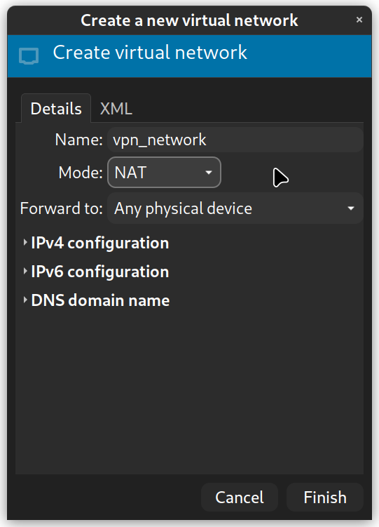

3.) Down on the bottom left of Virtual Networks window, click on the + icon to create a new virtual network.
4.) In the window that pops up, change the name of the connection to something that makes sense for you. I named mine vpn_network.

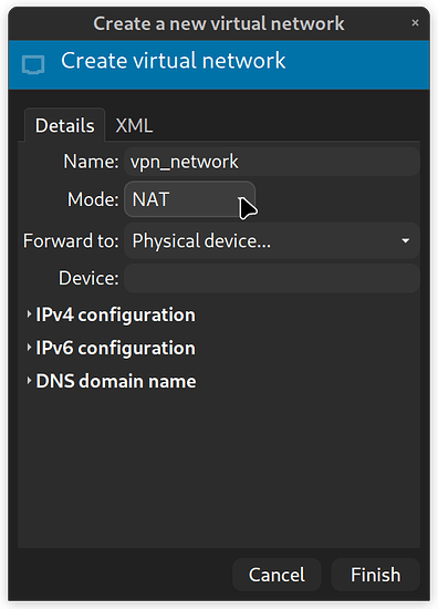

5.) In the “Mode:” drop-down menu select NAT.

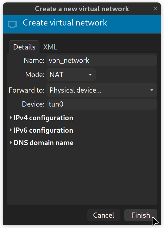

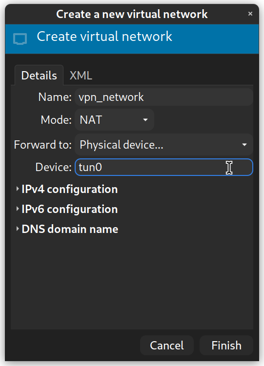

6.) In the “Forward to:” drop-down menu, select “Physical device”.
7.) In the “Device:” field type in tun0
***(If you’re on Linux and you don’t know what the interface is called that your host machine uses for the VPN connection just open a terminal and execute the command ip addr show and it should give you an idea. It should have the POINTOPOINT parameter in the interface details next to the name.) Here’s an example:
7: tun0: <POINTOPOINT,MULTICAST,NOARP,UP,LOWER_UP> mtu 1500 qdisc fq state UNKNOWN group default qlen 100 link/none inet 10.116.0.18 peer 10.116.0.17/32 scope global tun0 valid_lft forever preferred_lft forever
8.) Leave the IPv4 configuration, IPv6 configuration, and DNS domain name menus the way that they are unless you need something really special and you know what you’re doing.
9.) Click “Finish” to add the Virtual Network.

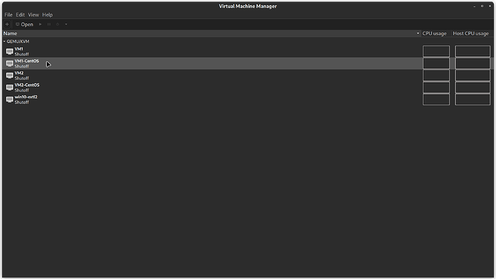

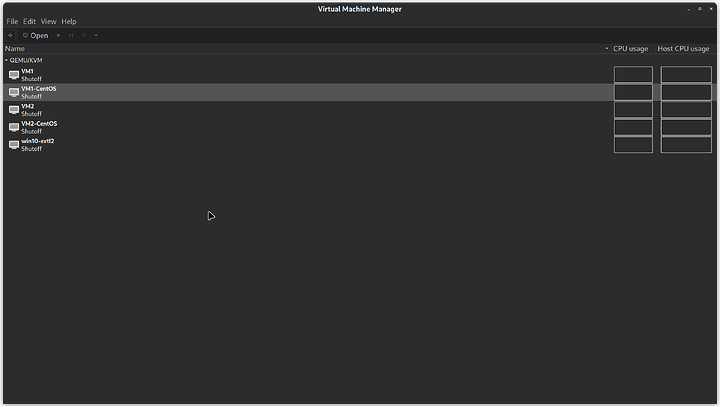

10.) Close the Connection Details window and go back to virt-manager where your virtual machines are located in the GUI.

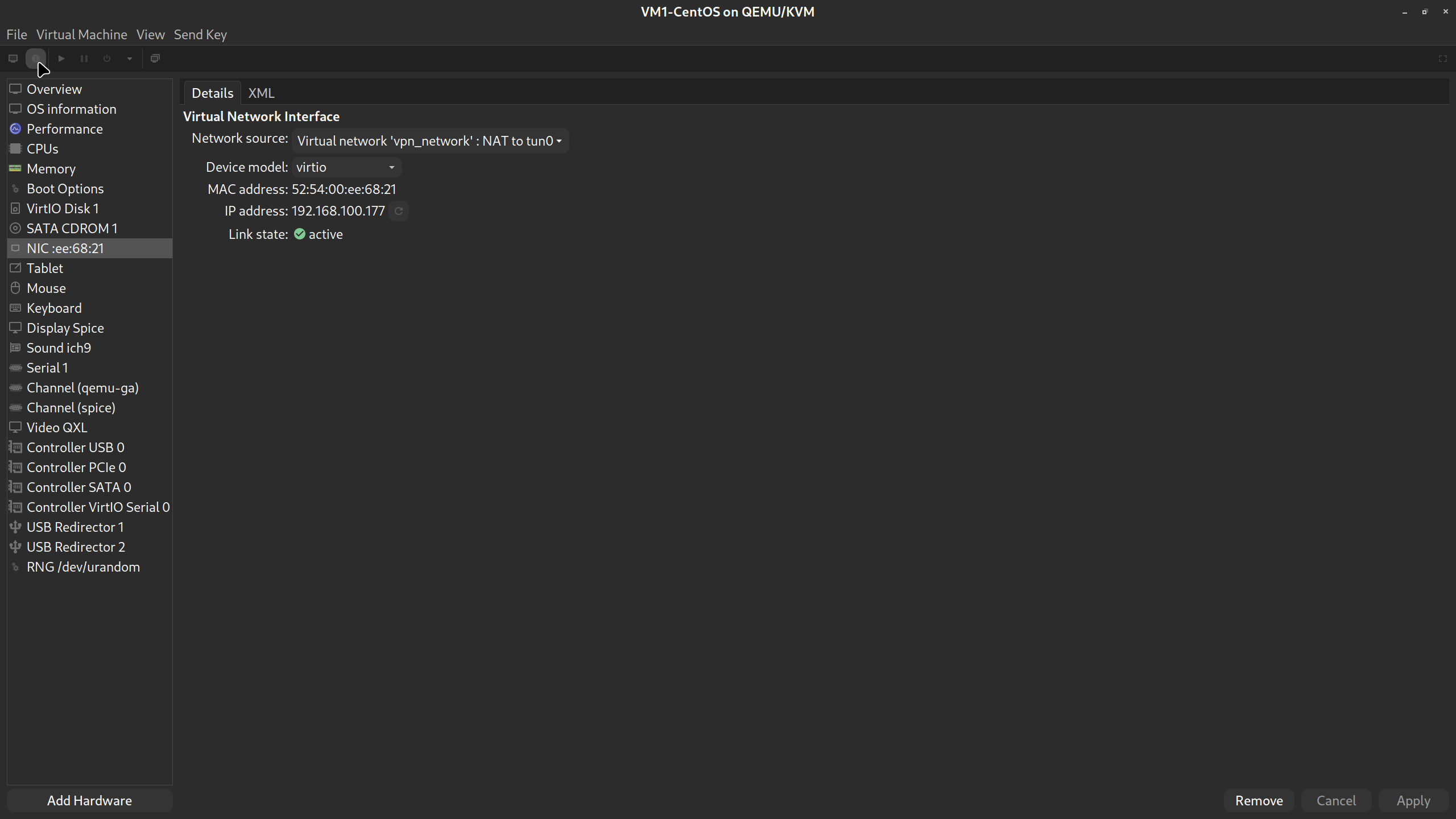

11.) Select the Virtual Machine that you want to change the network connection for so that you can access the internet from your VM while your host is connected to a VPN.

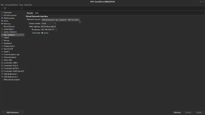

12.) Select Edit → Virtual Machine Details and click on the “Show virtual hardware details” icon. It looks like a little circle with an i inside of it.
13.) In the left menu pane select the item NIC:xx:00:00. It’ll be different for you but it starts with NIC.
14.) Now in the main window on the Details tab, select the drop-down menu next to where it says, “Network source:” and select the Virtual Network that you created earlier that is being forwarded to tun0.
15.) Now click “Apply” in the lower right corner of the current window and you’re good to go.
