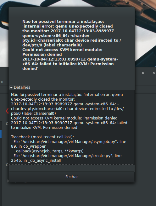

I was trying to create a new VM in Virt-Manager with Qemu.
I get to the start installation bit and I get this error:
The full error description is as follows:
Não foi possível terminar a instalação: ‘internal error: qemu unexpectedly closed the monitor: 2017-10-04T12:13:03.898997Z qemu-system-x86_64: -chardev pty,id=charserial0: char device redirected to /dev/pts/0 (label charserial0)
Could not access KVM kernel module: Permission denied
2017-10-04T12:13:03.899071Z qemu-system-x86_64: failed to initialize KVM: Permission denied’
Traceback (most recent call last):
File “/usr/share/virt-manager/virtManager/asyncjob.py”, line 89, in cb_wrapper
callback(asyncjob, *args, **kwargs)
File “/usr/share/virt-manager/virtManager/create.py”, line 2545, in _do_async_install
guest.start_install(meter=meter)
File “/usr/share/virt-manager/virtinst/guest.py”, line 498, in start_install
doboot, transient)
File “/usr/share/virt-manager/virtinst/guest.py”, line 434, in _create_guest
domain = self.conn.createXML(install_xml or final_xml, 0)
File “/usr/lib/python2.7/site-packages/libvirt.py”, line 3640, in createXML
if ret is None:raise libvirtError(‘virDomainCreateXML() failed’, conn=self)
libvirtError: internal error: qemu unexpectedly closed the monitor: 2017-10-04T12:13:03.898997Z qemu-system-x86_64: -chardev pty,id=charserial0: char device redirected to /dev/pts/0 (label charserial0)
I tried reloading the drivers by doing
rmmod kvm_amd
rmmod kvm
modprobe kvm
modprobe kvm_amd
But it didn’t work…
What am I missing?
Thank’s in advance!

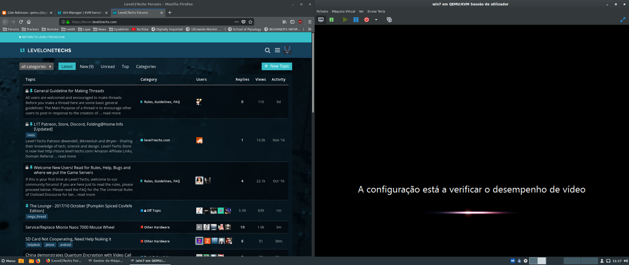

I found out something interesting…
In Virt-Manager I can select several types of hypervisor connections:
-The default one is QEMU/KVM
-The Second options is QEMU/KVM Session
And when I use that second type of connection…voila
This does mean that the options for the VM become very limited.
I still don’t know Why it does not work with the qemu:///system connection though :confused:
