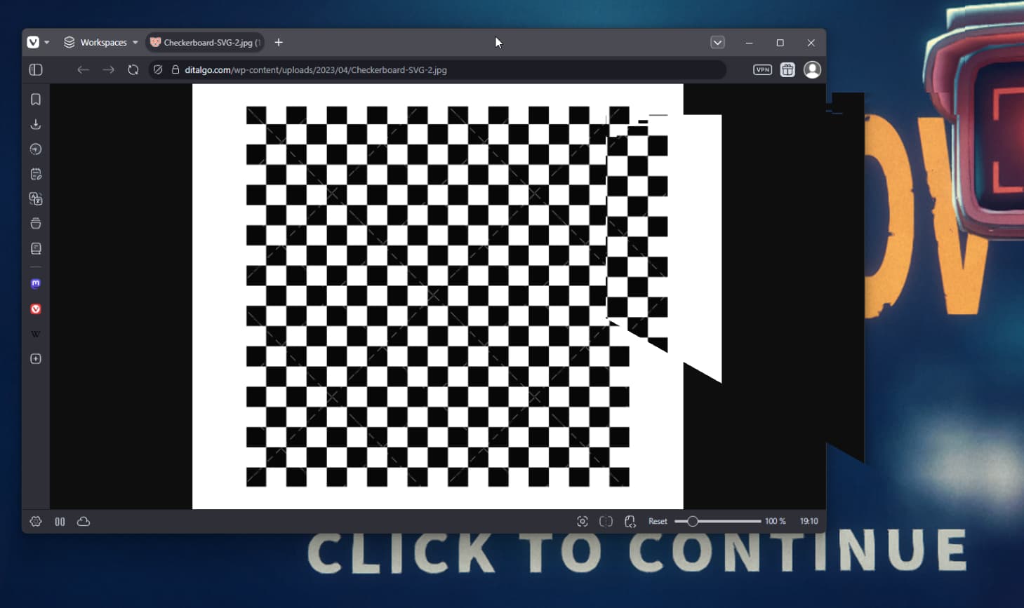

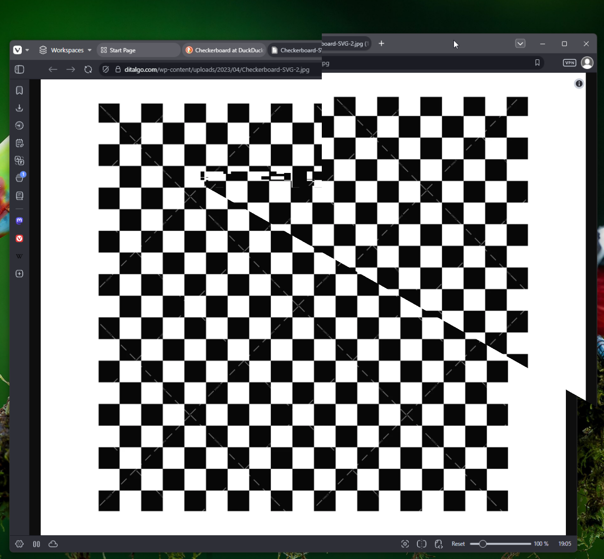

I recently installed cachyos and a Windows 11 virtual machine, to use for gaming. I noticed that there is quite a delay of the video stream with some diagonal tearing when using looking glass. So I created this post to get help from someone, who easily knows more than me.
The behaviour only seems to happen, when I connect using looking glass and not when I plug my main monitor in to the 4090 directly.
Thanks already for any inputs, as I’m quite new to the Linux world.

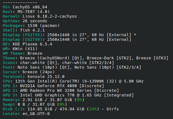

My current Setup is as follows
Host system
OS: CachyOS x86_64
Host: MS-7E07 (4.0)
Kernel: Linux 6.18.0-2-cachyos

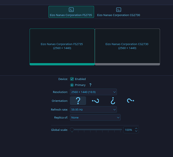

Display (FS2735): 2560x1440 in 27", 120 Hz [External] (Main Display)
Display (CG2730): 2560x1440 in 27", 60 Hz [External]
DE: KDE Plasma 6.5.3
WM: KWin (Wayland)
WM Theme: Breeze
CPU: 13th Gen Intel(R) Core™ i9-13900K (32) @ 5.90 GHz
GPU 1: NVIDIA GeForce RTX 4090 [Discrete]
GPU 2: AMD Radeon Pro WX 3200 Series [Discrete]
GPU 3: Intel UHD Graphics 770 @ 1.65 GHz [Integrated]
Memory: 21.18 GiB / 31.07 GiB
Client system
OS Name: Microsoft Windows 11 Pro
Version 10.0.26200 Build 26200
CPU: 6 Cores @ 2 threads
RAM: 32 GB
Disk: WD Black 2 TB NVME Disk
GPU: NVIDIA Geforce RTX 4090

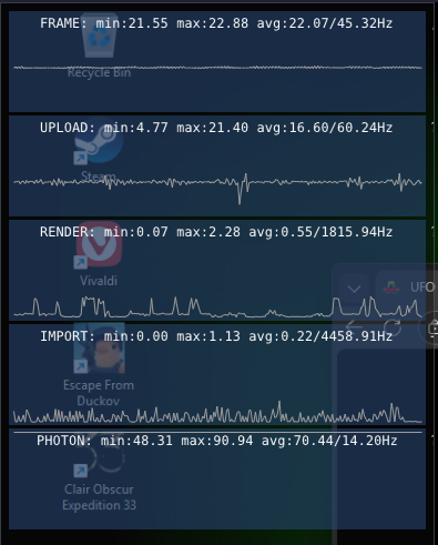

Logs
Looking glass host log
00:00:00.006 [I]              time.c:85   | windowsSetTimerResolution      | System timer resolution: 500.0 μs
00:00:00.006 [I]               app.c:867  | app_main                       | Looking Glass Host (B7)
00:00:00.007 [I]           cpuinfo.c:38   | cpuInfo_log                    | CPU Model: 13th Gen Intel(R) Core(TM) i9-13900K
00:00:00.008 [I]           cpuinfo.c:39   | cpuInfo_log                    | CPU: 1 sockets, 6 cores, 12 threads
00:00:00.009 [I]           ivshmem.c:132  | ivshmemInit                    | IVSHMEM 0* on bus 0x0, device 0x4, function 0x0
00:00:00.012 [I]               app.c:885  | app_main                       | IVSHMEM Size     : 32 MiB
00:00:00.012 [I]               app.c:886  | app_main                       | IVSHMEM Address  : 0x1F0A4FD0000
00:00:00.012 [I]               app.c:887  | app_main                       | Max Pointer Size : 1024 KiB
00:00:00.013 [I]               app.c:888  | app_main                       | KVMFR Version    : 20
00:00:00.013 [I]               app.c:917  | app_main                       | Trying           : D12
00:00:00.014 [I]               d12.c:200  | d12_create                     | debug:0 trackDamage:1 indirectCopy:0
00:00:00.045 [I]               d12.c:1025 | d12_enumerateDevices           | Device Name       : \\.\DISPLAY2

Screenshots
Heres a few screenshots.
Screen Tearing while moving the window

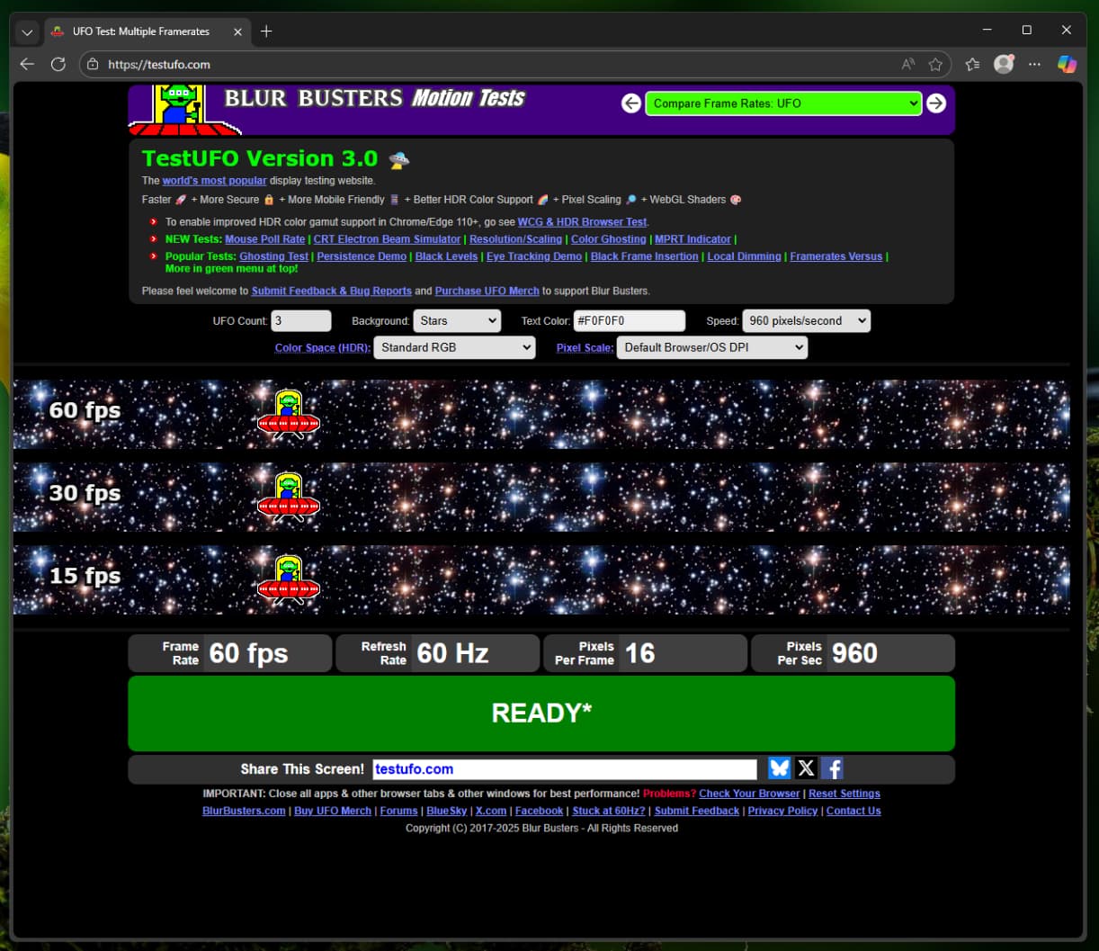

UFO Test
Frame Timing Information, with no movement of the mouse or a window
Frame Timing Information, while moving the Microsoft Edge Window

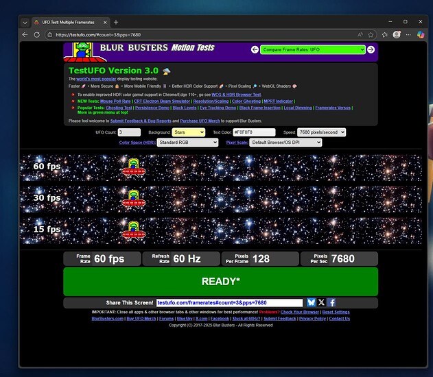

Please upgrade LG to bleeding edge and see if this is still occurring
I upgraded to the version B7-188-53bfb654 on my VM and client.
The tearing now won’t appear, with only a web browser window. The behaviour returns, while I got a game running in the Background. So in short.it appears better, but I’m probably still missing some kind of detail.

@Shadowbane I attempted your steps, but sadly without a significant change in the behaviour. You wouldn’t happen to have any other leads? As I’m kinda lost on how to proceed further.
Thanks already for your time.
I did the following
  • updating my system
  • installing sudo pacman -S plasma-x11-session
  • restarting and switching to x11. So i get WM: KWin (X11) when I open my terminal.
  • reenabling IOMMU after the update.
  • starting the VM
  • setting the refreshrate on linux and in the vm to 60 Hz
  • Testing the same thing again, with a game running an moving a my webbrowser about.
looking glass client log

My previous message was already with an X11 session. I probably didn’t mention that clearly enough.
My monitor of my host and client are set to 60 Hz, and won’t affect the behaviour.
The UFO Test seems fine, but I still notice the tearing sometimes. So, like I mentioned, it seems to happen less since updating to bleeding edge, but it still happens.
I tried launching LG using looking-glass-client -vsync off -win:jitRender=yes -capture dxgi in fullscreen and It didn’t seem to change any of the previously mentioned tearing.

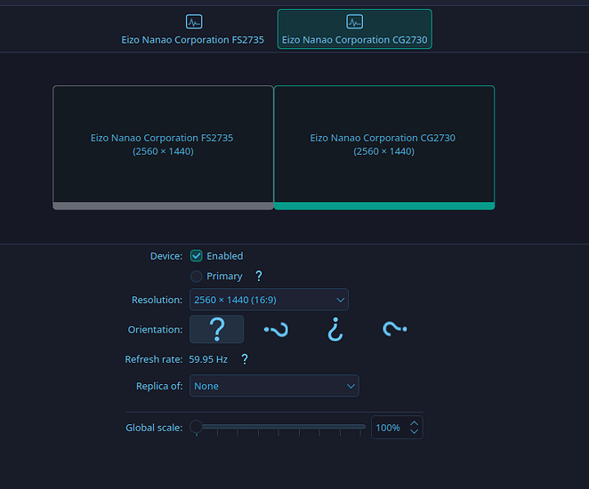

I’m currently not certain, on to make sure that VRR/G-SYNC isn’t enabled. I don’t see any mentions in the OSM of the monitor.
Yes, both Monitors are on 59.95 Hz and with X11.
The Driver version is currently 591.59 in windows and 590.48.01 if I don’t enable IOMMU.
Monitor Settings
Screenshot_20251219_181745
I want to use both monitors in daily tasks, without replugging my monitors.
