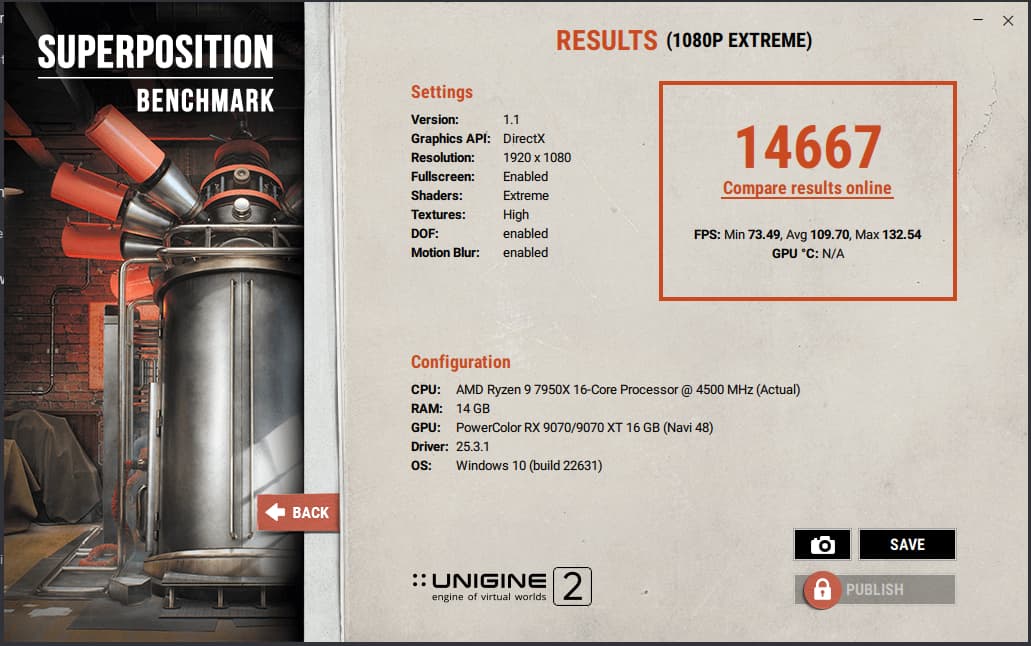

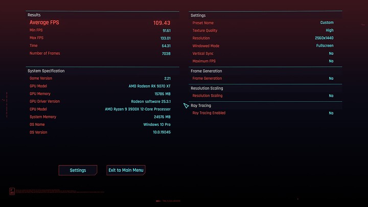

So I just got my 9070XT installed and pcie pass through is working as expected, it also can survive the VM rebooting.
Video attached as proof, I’ll be posting more information on my setup later today for anyone that’s interested
FYI @wendell unsure if you have done much tests of this card in a VM but it seems pretty much the same as my older 6800XT

A quick superposition benchmark indicates that the GPU is working along the same lines as others. (Googled some other scores for 1080p extreme and they are in the same ballpark)

Do you have Cyberpunk? Can you please see if the game runs at all on Win11? On Win10 my first launch was very slow/stuttery, but the game eventually loaded and ran for about a minute, then crashed. Next launches after that it was crashing instantly. I had to remove the shaders in %localappdata%\AMD for it to start and go thu slow loading time and crash after a minute again.

No worries, I played for about 15 min and it was perfectly stable and performance is in line with reviews.

Ok, I ‘fixed’ it.
TL;DR download more RAM bro.
Before I started doing anything I decided to have another look at your XML file. The very first thing I noticed that you don’t use hugepages, I thought “weird, but ok”. I removed hugepages from my XML – had no effect. I reverted the change and decided to check the Event Viewer in Windows. Found nothing suspicious in the ‘Application’ tab, but encounter something interesting in the ‘System’ tab. Warning “Windows successfully diagnosed a low virtual memory condition. The following programs consumed the most virtual memory: Cyberpunk2077.exe (11444) consumed 17629413376 bytes, AMDRSServ.exe (11744) consumed 743927808 bytes, and MsMpEng.exe (3948) consumed 307421184 bytes.” Cyberpunk eating 17 gigs of memory, even tho I only allocated 16 for the VM, but I also have a pagefile of 8. For some reason I couldn’t submit to the idea that 16 gigs is not enough for any game, there was no way, especially when your setup is using 14.
Windows version of OOM Killer was just killing the process. At that point I thought to myself: “before I start this Windows reinstallation nonsense, let me just increase the damn thing (especially when I have 64 total on the host) and see what happens”. I changed the kernel parameters from
rw amd_iommu=on iommu=pt default_hugepagesz=1G hugepagesz=1G hugepages=16
to
rw amd_iommu=on iommu=pt default_hugepagesz=1G hugepagesz=1G hugepages=24
and in virt manager from 16384 to 24576. Booted the VM, cleared the %localappdata%\AMD shaders and started the game. It loaded no problem. Here are the vids of ‘before’ and ‘after’ (can’t include the full links).
Before: 16GB RAM – 1080p
watch?v=OCzI0g79DVQ
After: 24GB RAM – 1080p
watch?v=YhQSgqQRmLw
After: 24GB RAM – 1440p downscaled to 1080p with AMD’s VSR
watch?v=sUCOxcc_9LU
And with mitigations=off kernel parameter I got ~14 Avrg FPS increase
As for my specs, I got Ryzen 3900X, Crosshair VIII Hero, 4x16 G Skill Trident Z Neo at 3600 MHz and replaced my Asus 2070S with Gigabyte Windforce 9070 XT. Pretty old stuff, didn’t change anything since 2020.
P.S. I’m not sure this is 100% fix, as I only tested benchmark and a little bit of gameplay. Long play sessions may prove that this is not a fix, but a band aid. But at least I started with not being able to play the game at all to benching and recording a vid at the same time :slight_smile:
Forgot to mention, I also have a 1050Ti for my host. Two monitors, first connected to the 1050Ti, second connected to the ‘main’ GPU. I don’t have to kill the display manager, unbind amdgpu and start the display manager. I just press ‘Play’ button in the virt manager and amdgpu driver does its thing. The only change I had to make from my previous 2070S setup was to comment out the options vfio-pci ids=... in the /etc/modprobe.d/vfio.conf file and let the amdgpu to take control.
