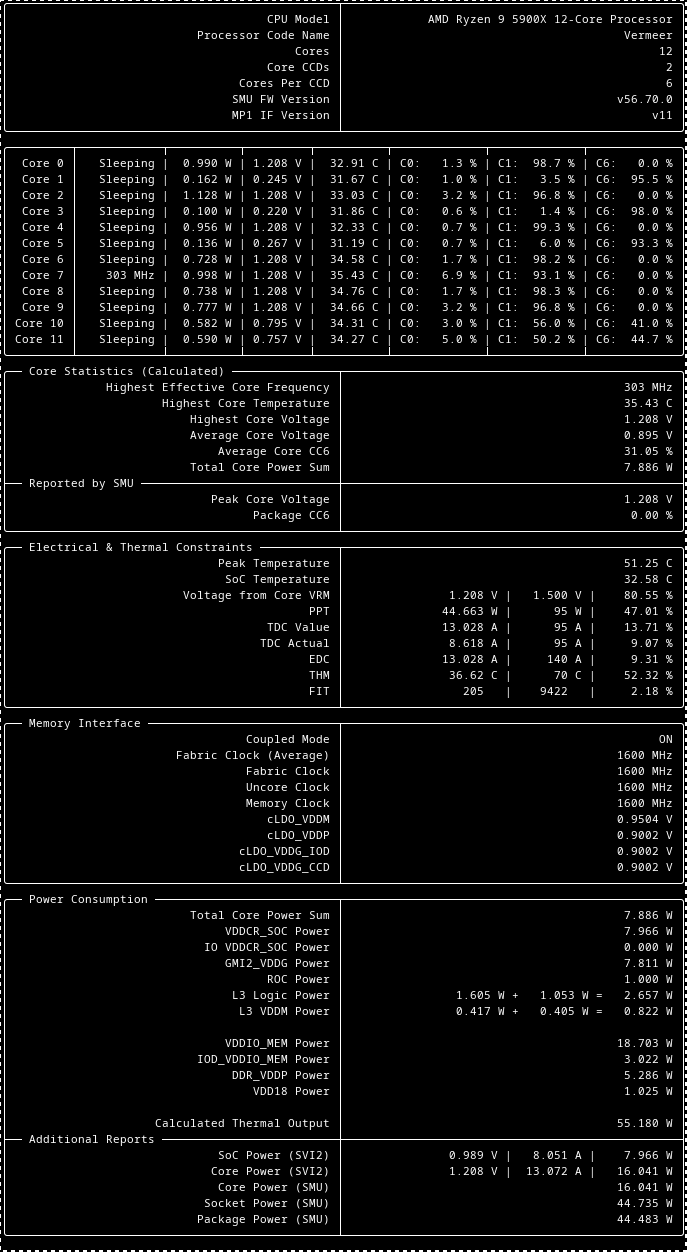

Here’s some readout from my zen3 cpu. Looks like even with 1.2v and jedec, memory is about 20w. Do any AM4 boards support undervolting memory? Like, below 1.2v?
stuff
Mind sharing what utility are you using for that readout? Looks nice.

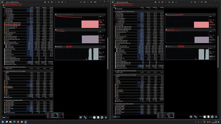

This is what much higher power draw ryzen 7950x3d looks like when using OC memory (DDR5 4800 → 6000):
This is the same measurement if pc left totally idle for 10 minutes (shower time). Notice how low power goes:
Old comparison from exploding x3d chips EXPO ON and OFF:
It’s just called ryzen_monitor, and is available on aur.
github
GitHub - hattedsquirrel/ryzen_monitor: Monitor power information of Ryzen processors via the PM table of the SMU
