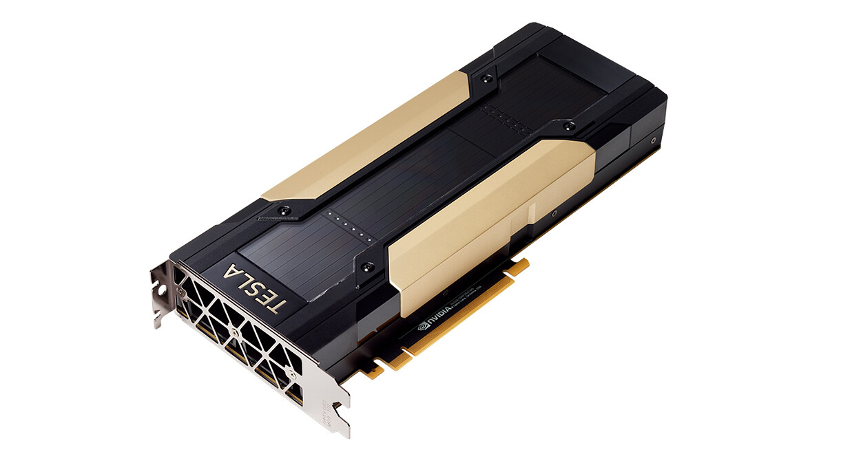

I recently got a couple PCIe V100s to tinker with and I’d like to know if anyone has seen these connected with NVLink bridges? I haven’t been able to find any info on this being deployed. Best I can find is the V100 DGX Station but those appear to be different boards.
The PCB definitely has two sets of edge connectors on top for bridges. I’m assuming it’s probably the same board that’s used on the GV100. The backplate and heatsink shroud currently prevent any kind of connector from fitting but that can be modified.
I have some GV100 bridges on the way now. Has anyone seen these cards with bridges installed before?
Are they SXM2 modules attached to PCIe adapter boards? If so, then it may be more simple to buy a dual SXM2 board and use that as it allows NVlink. You may need to get a different cooling solution however.
No it’s the PCIe version like the one pictured above.
The V100 PCIe version theoretically supports NVLink, but cards sold on the market typically do not have this feature enabled. You’ll need to verify that the connector on the PCB is actually powered and that the BIOS supports it.
