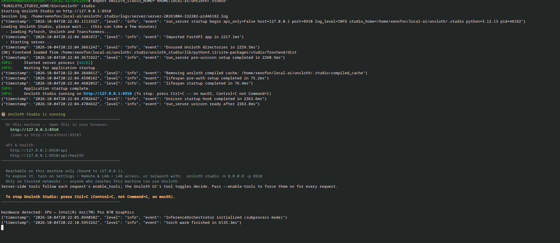

Starting the server

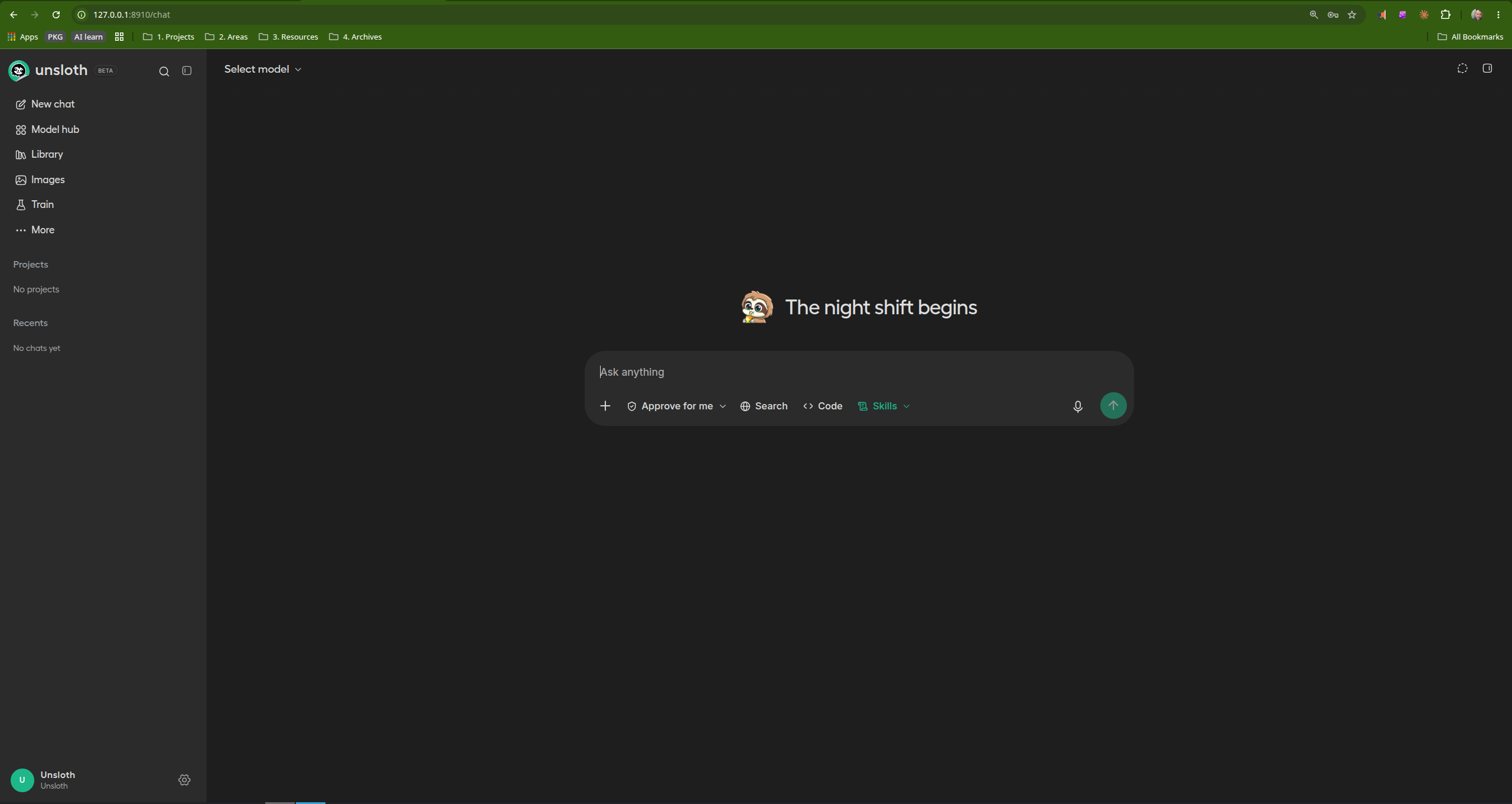

So I set a studio-pin.sh which sets the Studio default, the launcher base, and the client’s fallback URL to 8910. This is something I do for my needs, you may not have to. Launch with no port flag;
export UNSLOTH_STUDIO_HOME=“$HOME/local-ai/unsloth/.studio”
“$UNSLOTH_STUDIO_HOME/bin/unsloth” studio
Studio answered HTTP 200 on 127.0.0.1:8910. The socket was bound only to that address. The gateway on 8888 was still the same process, and Studio was then stopped. Separately, a parent environment that selected Level Zero device 0 and set an affinity mask still produced one device, the Arc Pro B70.
