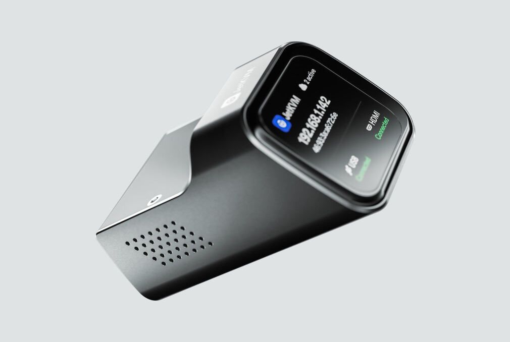

To answer your question: Have you considered solving this in another way? What if you use something like a PiKVM or a JetKVM? Is the objective just the ability to put distance? This could be a contrived way to do it.
