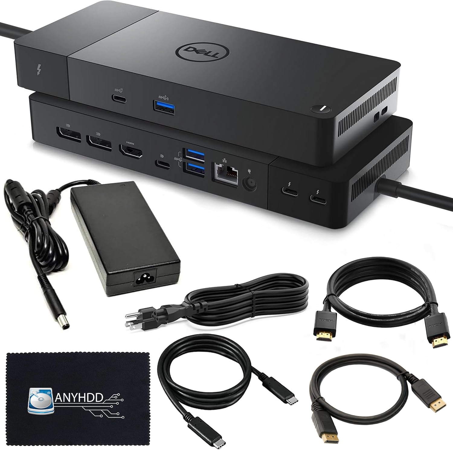

To add to the question @Level1_Amber , if this is a hardware limitation, and thus has to be solved with extra devices, would you perhaps know a USB-C hub, that would be able to pass through the 40Gbps video signal and provide PD from a power adapter?
This is a hardware level chipset limitation.
Your best (most affordable) bet might be to get a used dell or lenovo dock. A cheap USBC dock probably won’t be TB4 (40gbps) Here’s an Amazon example but you could always try eBay too.
