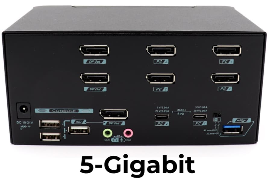

Hi, I’m looking at the combo KVM and I noticed a combiner is necessary to connect my Windows PC if you only want to connect the Mac via one USB C cable and nothing else.
My question is why is it necessary for the combo KVM but not for any of the other KVMs? Eg i’m looking at the single monitor HDMI2.1 KVM, and you just need two HDMI cables, two USB C cables and nothing else.
Would it be possible to connect my Mac and PC to the combo KVM the same way? DP + USB C for each of my Mac and Windows computers?
So the combo KVM has display & data connections in the bottom USBC ports.
The HDMI you referenced, and all of our other KVMs, have only data connections in the bottom USBC ports. No display.
The combiner is to make your display connection and your data connection combine into 1 USBC cable for the combo kvm.
So, if you look at this DP KVM:
This is a 2 input 2 output KVM with the bottom usbc being only for data.
and if you look at this combo KVM:
This is a 2 inut 3 output kvm because the bottom usbc is display & data instead of data only.
I guess my question is: can we treat that usb c port on the combo KVM as just a data port, effectively mimicking the other KVMs? This would look like
PC1 (Mac): DP + USB C
PC2 (Windows): DP + USB C, no combiner
which is just like the other DP KVMs, except with power delivery.
And thanks for the explanation!
Yes the combo KVMs can be used without a Combiner, but it would be turning a triple monitor into a dual and would be more expensive than just buying the DP dual monitor KVM. Also the connection would be more expensive slower usbs. The combo KVMs are 5-gigabit and the DP USBC KVMs are 10-gigabit
Ah I see. Will just evaluate for now if I’m willing to sacrifice data transfer speed for power delivery, at a higher price.
Thanks Amber! You’ve been super helpful :slight_smile:
Yea, the problem is 5gb USB and 10gb USB KVM is out of stock :smiling_face_with_tear:
They are on order!
