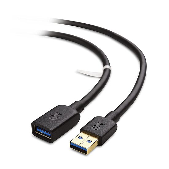

I need a USB 3 extension cable for my webcams. Will a regular 10’ extension be fine or do I need to get an active/powered cable?

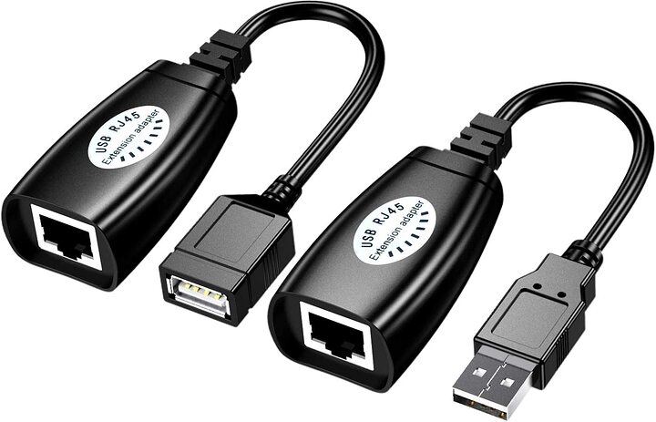

should be fine, but for about the same money you can get cheap converters that use CAT5/6 and will often let you run up to 100 ft.

Will most likely work fine with 10’ extension. I’ve had good luck with Cable Matters brand.
Or about half the price is you only need 2.0
These seem to be USB 2.0 only. Finding one that supports USB 3 is not easy. It would seem that Ethernet should be able to handle the duties of USB 3 quite easily.
ahh yeah no you wont find cheap ones for USB 3. Sure the cable can do it, but the electronics on either end tend to be $$$$.
The cheapest reliable one for that I have found is about $1000.
Yeh, I’m seeing that … that’s just stupid.
yep… I am going to bite the bullet soon and get some though because I really want faster USB between my rack and office. I have been hoping for the last several years they would come down in price but I guess someone out there owns a patent and is being a dick with licensing.
looks like i’ll be better off with just standard extension cables and see if that works well enough
if your under 10 feet then yeah! since it sounds like you need 3.0 speeds.
