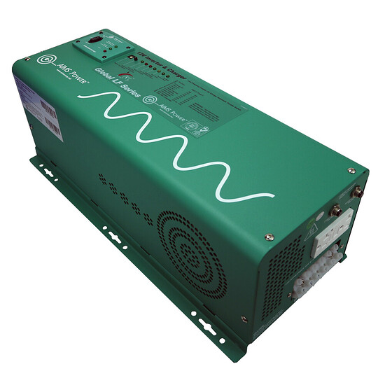

I was looking at a 48v rack mount inverter by the brand AIMS. But i couldn’t find any reviews on it. And i never heard of the brand before. But it did convert 48v batteries over to 120v. But it was expensive.
I have a 12V AIMS inverter/charger. Very nice build quality. I have it hooked up to an AGM car battery as a backup for my fishtank.
Something like this but for sure only 1250 watts. I don’t think they spec out a transfer time, so I’m hesitant to use it on my computers. I seem to recall that the pumps on my aquarium sputter a little when the power cuts over, so probably no bueno for a UPS.
Edit: I can’t recall if it was this expensive when I bought it, but I also bought a smaller unit, several years ago. For sure I wouldn’t pay $800 for a fishtank backup. I think the rating is for continuous power, so that is worth something.
