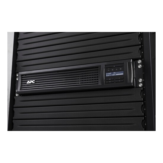

I happen to have the 230V variant of this APC UPS unit:
No complaints so far :wink: Got it used (missing the front panel) and I had to replace just the batteries. Having an electronics background that was significantly cheaper then the entire battery pack. IIRC I spend €120-ish for 4 batteries vs a 600€ APC branded battery pack. :money_with_wings:

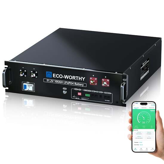

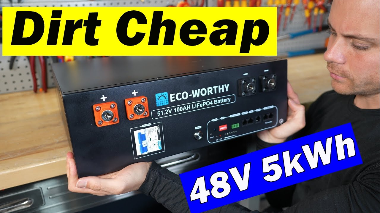

Obviously this calls for a server rack lithium battery! :grin: (Combined with maybe a Victron inverter or something like it.)
Edit: Heck, there are even 48 VDC input PC power supplies! No inverter needed, “only” a battery charger!
(Note: I have no experience with any of this. Just making a bad joke while supplying some links that might possibly be of interest.)
Certainly is! Now if only those prices come down :wink:
