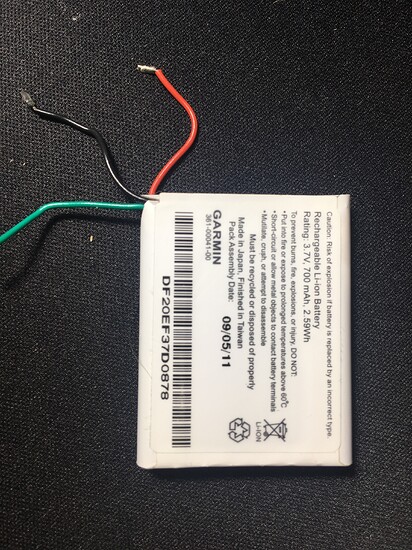

I just upgraded it by solderig on another battery i had laying around. Both lost some charge through years but now i have twice the original
Just to add, i’ve just done something similar , i used a new 1000mah battery compatible with the Logitech G900 . The original connector is a PIA to find and adapt, so i just solder the battery into the 3 holes in the pcb for + - and temp sensor.
Edit:: With 1000mah i’m at 15 days of heavy use (15 hour a day or so) and the battery is still 2 bars. Lets see how much it last.
Edit2: final measure, 22 days , that is good enough for me, probably you can fit a 1500mah battery, for around 30 full days
