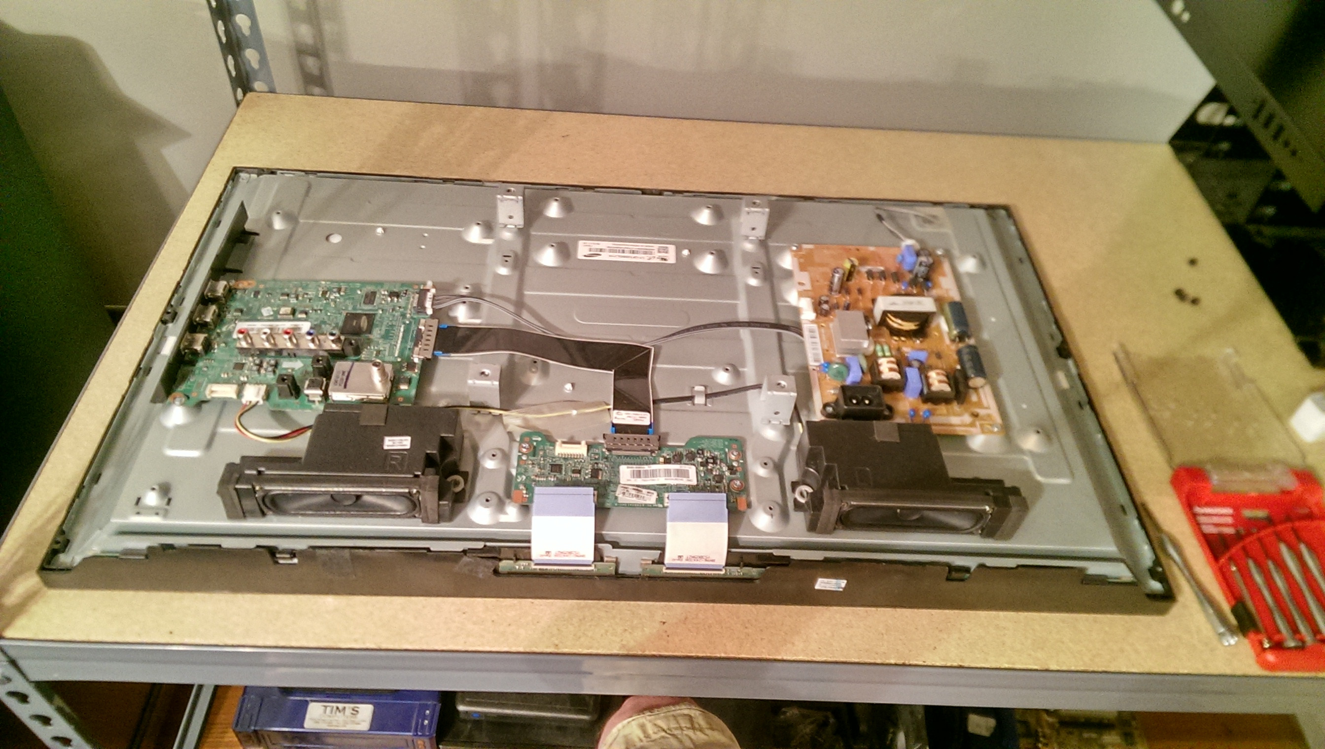

Was watching stuff on this TV and the image just died all of a sudden. Audio still played, backlight bleed was still there, but no image.
I took it apart to see if anything was very obviously fried. Nothing apparent.
Started googling what each board did and found this video on how to troubleshoot a TV.
If the orange/brown power board works then the backlight should be visible; it is.
If the Audio plays and the screen doesn't display an image then the board with all the audio jacks (mainboard?) works.

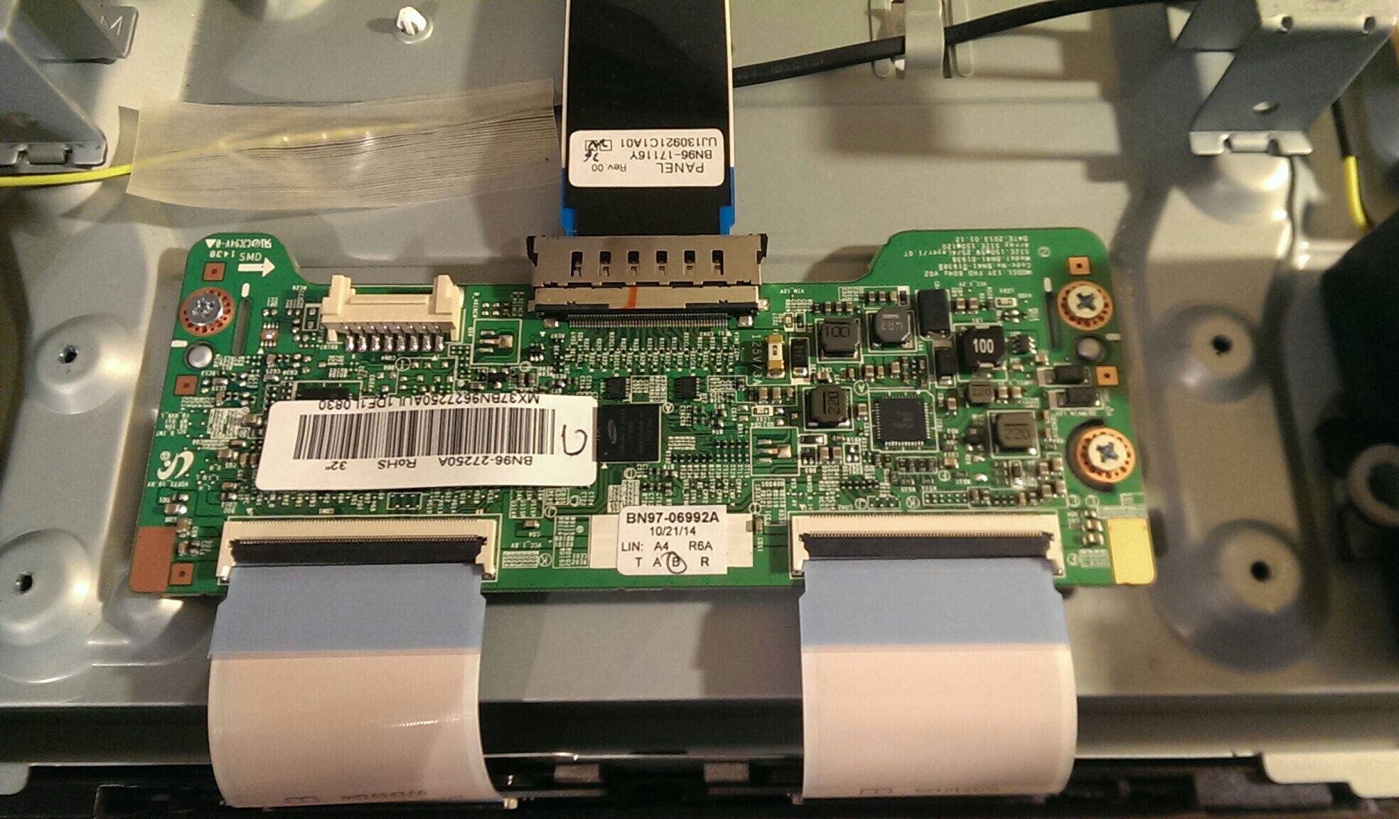

That leaves the board at the top. The T-con board. The one shown below.
I couldn't find any tutorials on how to fix the board itself so I guess I have to replace it.
The video says to check the model number of the TV and google for a T-con board for your model.
I found a few different ones for sale.
This is the closest one I could find:
http://www.ebay.com/itm/Samsung-UN32EH5000F-T-Con-Board-BN97-06992A-/262030022473
I'll update when it comes in.

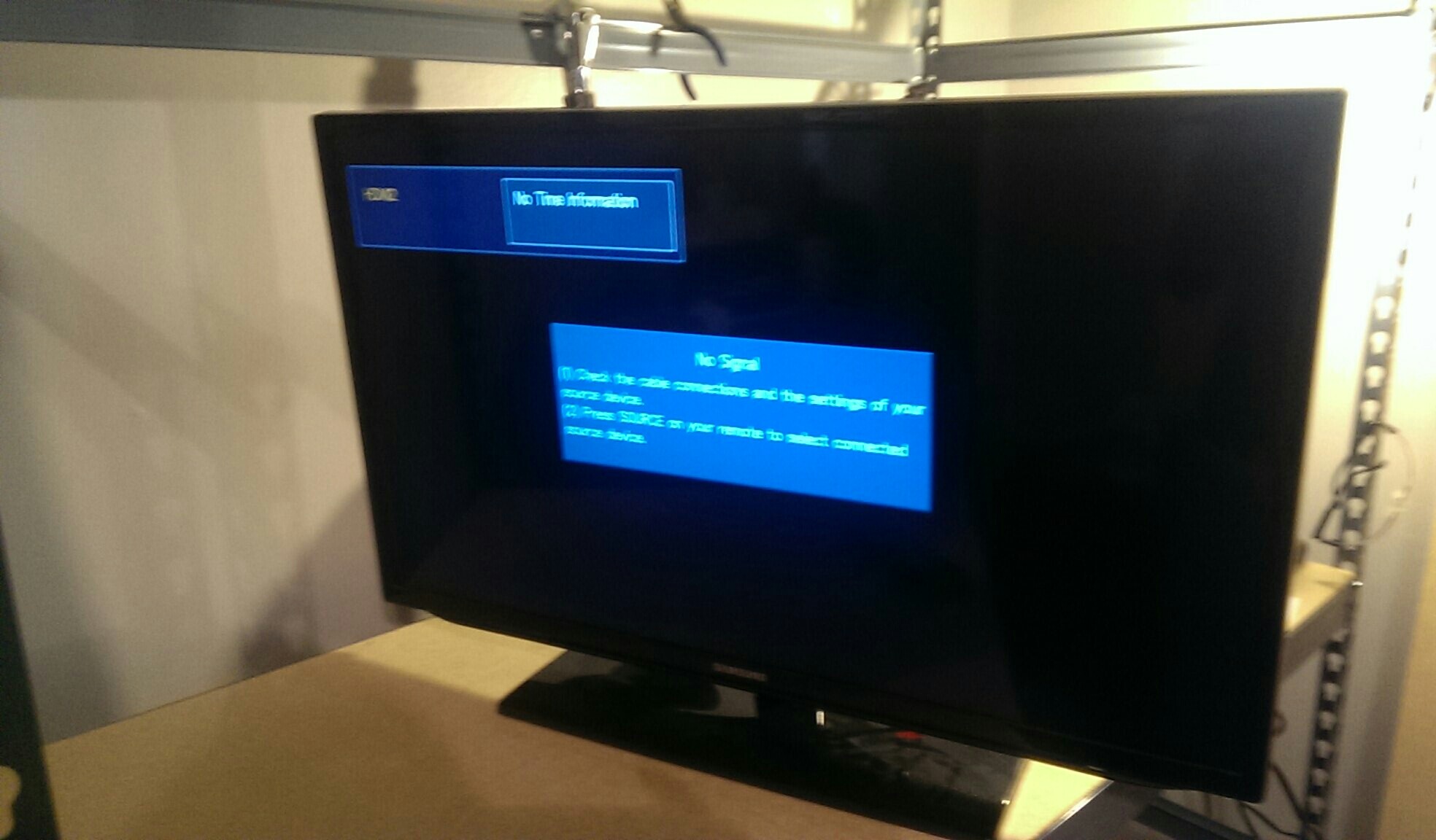

Just got the new T-con board in.
$25
It fucking works.
Niiice!
