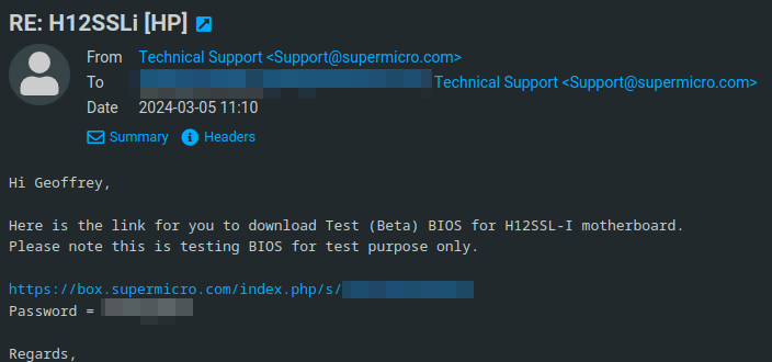

While there is no officially signed contract/agreement, the fact that this is copyrighted, shared with a private URL, and password protected, and specified that it’s a “testing BIOS for test purpose only” it is very clear that they do not want this released to the general public by me.
Not only would I be in breach of their copyright by distributing this image, it would be disrespectful to SuperMicro and the staff member(s) that have been working to resolve this issue for free on a discontinued motherboard.

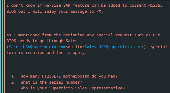

Usually custom changes to a BIOS outside of the specification in the manual require a contract with the manufacturer, for example:
