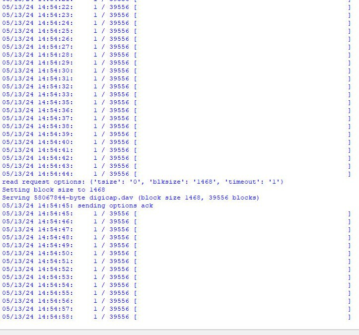

Hi, Thanks for explaining everything. I am having issues stuck on block 1 / 39556. Checked the firewalls and everything looks good.
Anyone have an idea what could be causing this?
Thank you
looks like hardware issue, reading or writing to blocks.
I assume this is the upload log, i would check all the wiring for corrosion and that water has not got into the camera

looks like its connected, but running super slow. after 10 mins all I have is this? (connected via eth. machine and camera on the same POE switch)
PC:~/Downloads/hikvision-tftpd-master$ sudo ./hikvision_tftpd.py
Setting block size to 512
Serving 23458645-byte digicap.dav (block size 512, 45818 blocks)
Mon Dec 30 22:18:08 2024: Replied to magic handshake request.
Mon Dec 30 22:23:27 2024: Replied to magic handshake request.

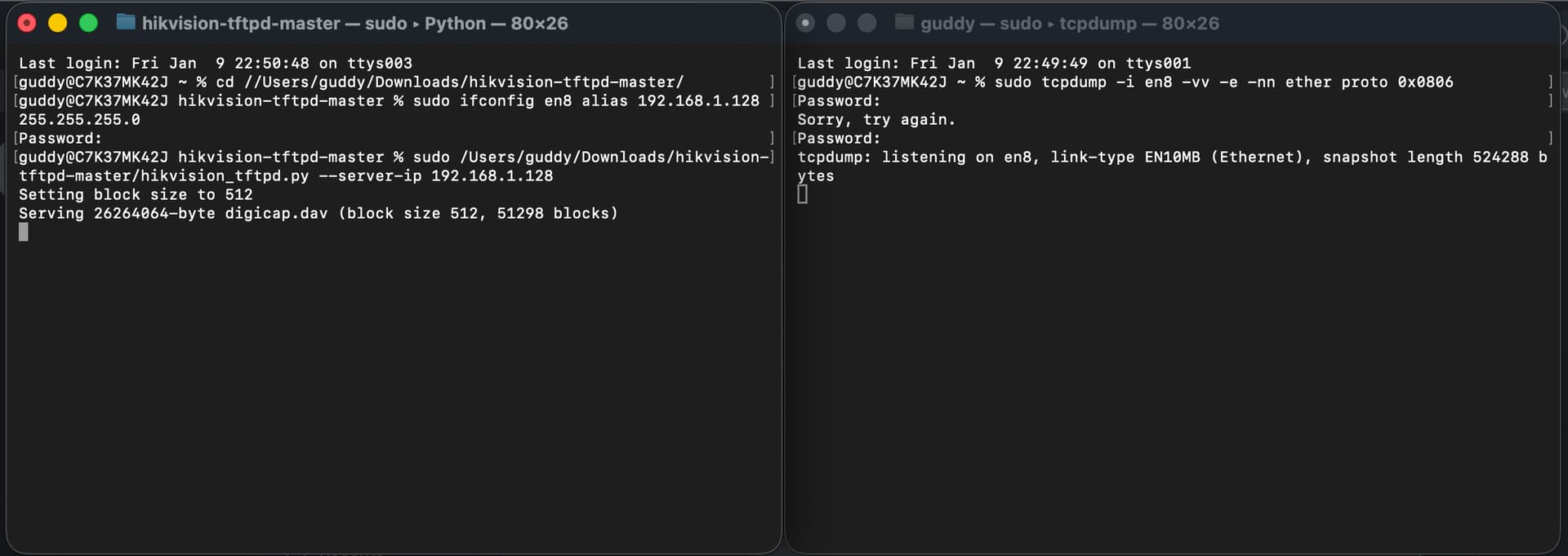

Hi, and sorry to revive the topic here. I’ve been trying to get DS-KV8113-WME(C) back to life after a botched Firmware update (apparently, I should have updated each small version, not directly to the new one).
This guide is the first one that allowed me to make progress. Using Hikvision’s own TFTP tool on Windows didn’t work because it was not getting a response from the device.
Using the Python script, I also don’t get a response. It is loading the firmware file, but not getting the call-back from the device, regardless if I use the 192.0.0.128 or the 192.168.1.128 IP address.
Finally, after using Wireshark to watch over connection requests, I saw “dead-silence” using the 192.0.0.128 IP, but got a response using the 192.168.1.128 IP. The problem is that it was rotating between a 192.168.1.120 and a 192.168.1.144 (I am unable to verify if the MAC address is from the device, but considering that it is the only thing connected to my Macbook, I can assume it is).

cna you post more info about your wireshark dumps? perhaps the camera is connecting to tftp but not finding the file its looking for, or something like that. you may need to hard wire your macbook in as tftp via wifi is a recipe for headache in this type of scenaro usually

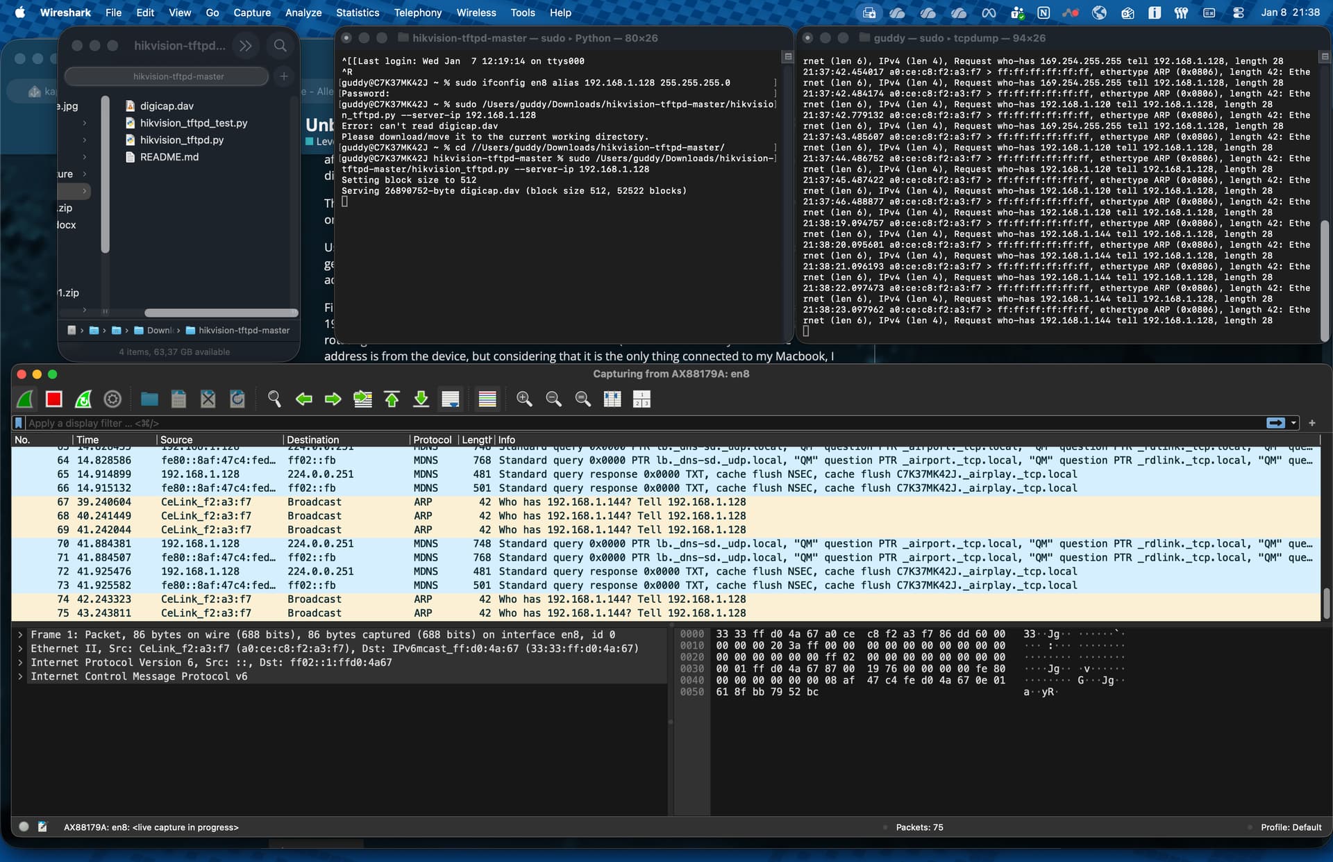

Thanks for the quick reply. I am adding two screenshots:
  • the first shows the folder in which the firmware file is and where the python script is being run from, next to the terminal window running the python script and the terminal window with Wireshark being called

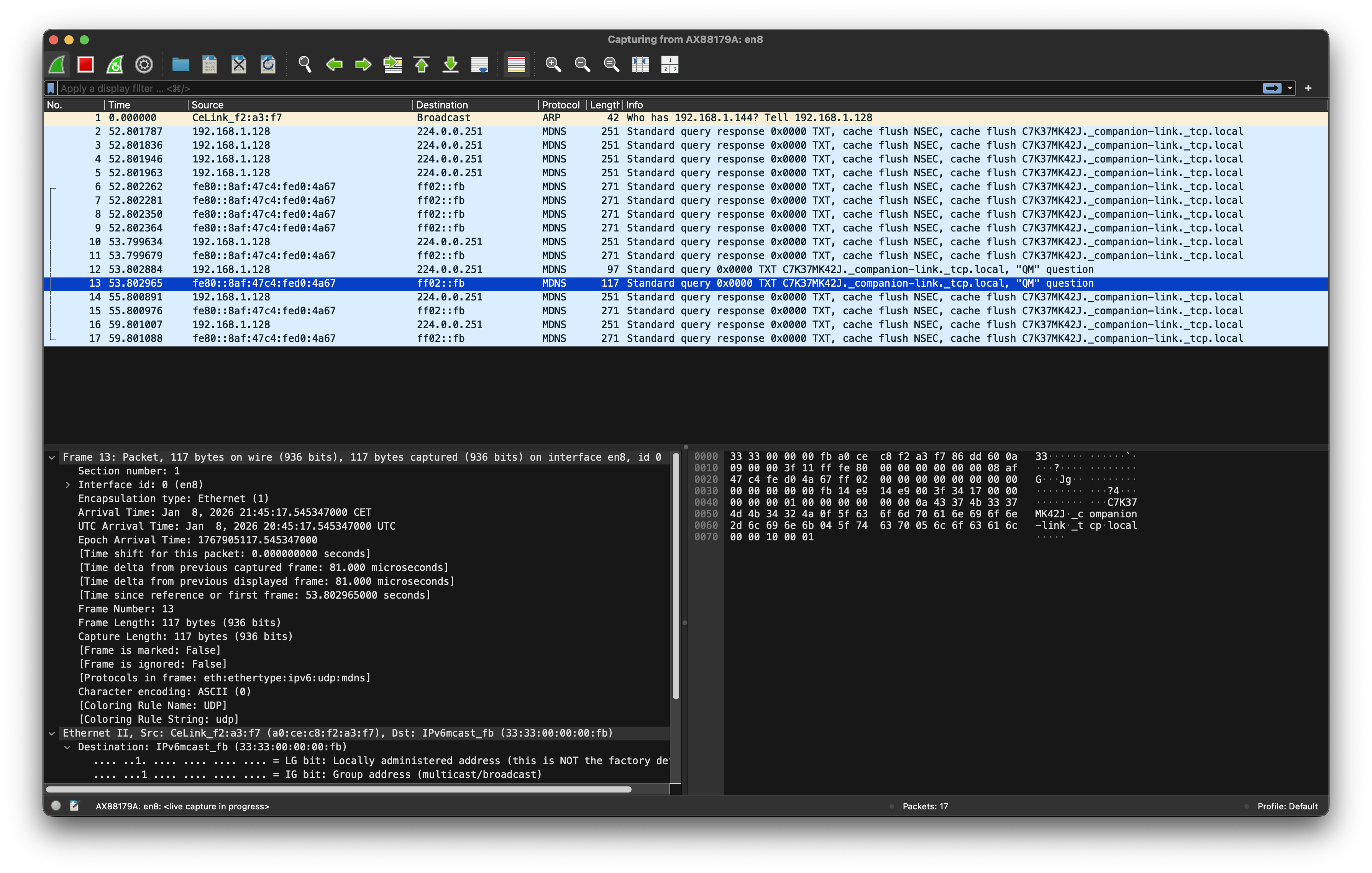

  • the second one shows Wireshark running AFTER I stopped everything and tried to run SolarWinds’ TFTP App in Parallels using Windows 11 (the network connection is bridged).
Things to note:
  • Wi-Fi is switched off for the MacBook in both scenarios.
  • en8 / AX88179A is the USB-C dongle I use to connect the Ethernet cable to my laptop.
  • en8 is bridged to Parallels (I got a call-back from one of my functioning PoE HikVision screens when I connected it).
I really appreciate the help. Thanks!
mdns doesnt matter for us, filter it out (ai helper can give you the syntax)
arp… probably doesnt matter (it might)
the output here suggests it is serving the file to the camera, but perhaps the camera is not applying it. have you tried other files/versions? newer/older?
I forget if the script tells you when the client asks for a file but its not there. I have a vague memory of watching for files the camera asks for, that aren’t there, and using that as a clue to give it what it wants.
the fact it does seem to be loading the file is a great sign, and suggest its either not flashing the file (because it doesn’t match some check)… could be from too new, or too old
