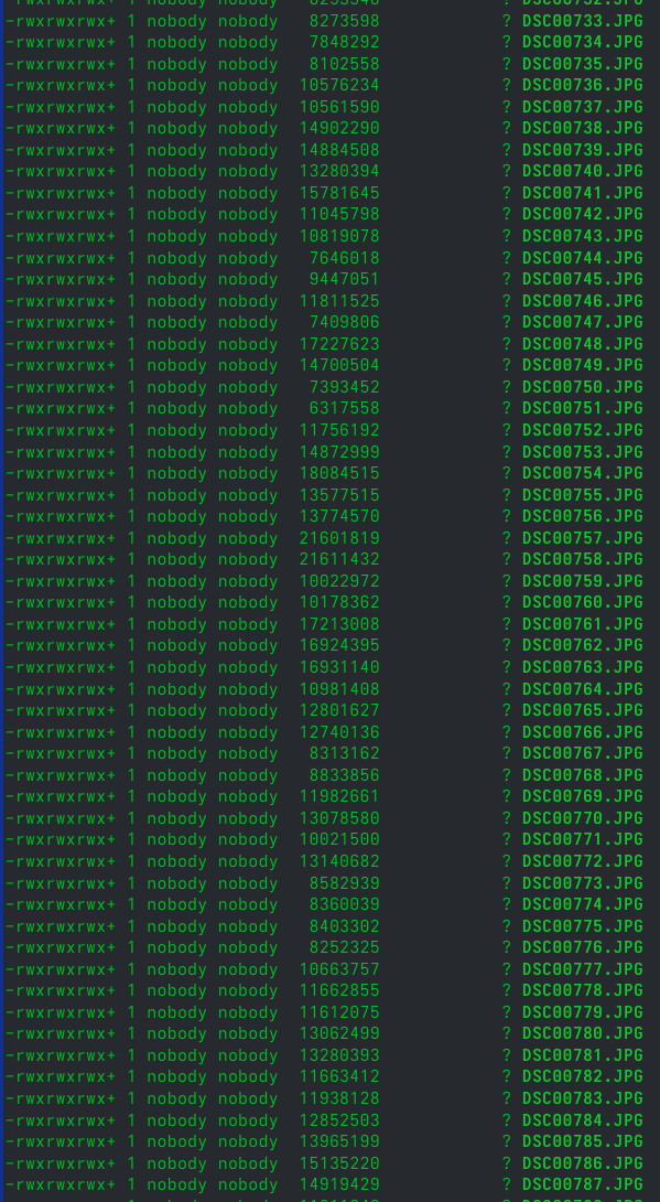

It’s not Dolphin. My Dolphin works fine on sort by Created, just checked. Can you check in the terminal via ls -lt --time=birth?
(I hazarded it wasn’t Dolphin in my original post, as I mentioned it didn’t work in Nemo either - to add to that, I was about to reply to @anon21802893 that I had not tried any CLI commands so far as it is so far outside the scope of my usage of the NAS in its typical daily operation that trying to verify using CLI commands never crossed my mind at all)
I think those question marks look a bit sus.
“Transcend” in that file path brings me back to what I said (edit in previous post). Is your NFS share an SSD mounted (on the host / NFS server) in a way that ignores atime/mtime/ctime meaning there is no sortable time data to share to clients.

yeah, when those files were created, something didn’t write the metadata correctly…certainly not a,b,c,whatevertime.
So…looks like the files themselves are sus, not Nemo or Dolphin :wink:
That’s my guess too. Or some app writing the stuff not being POSIX-compliant or whatever

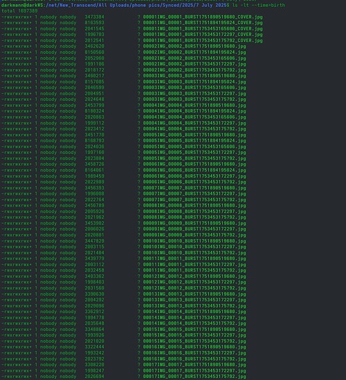

So, those were pictures from my phone, as I’m sure you ascertained. However, the same occurs when I repeat the ls on a dir of files downloaded from the internet to the NAS through this CachyOS install. (no screenshot of the nature documentaries here :wink: )

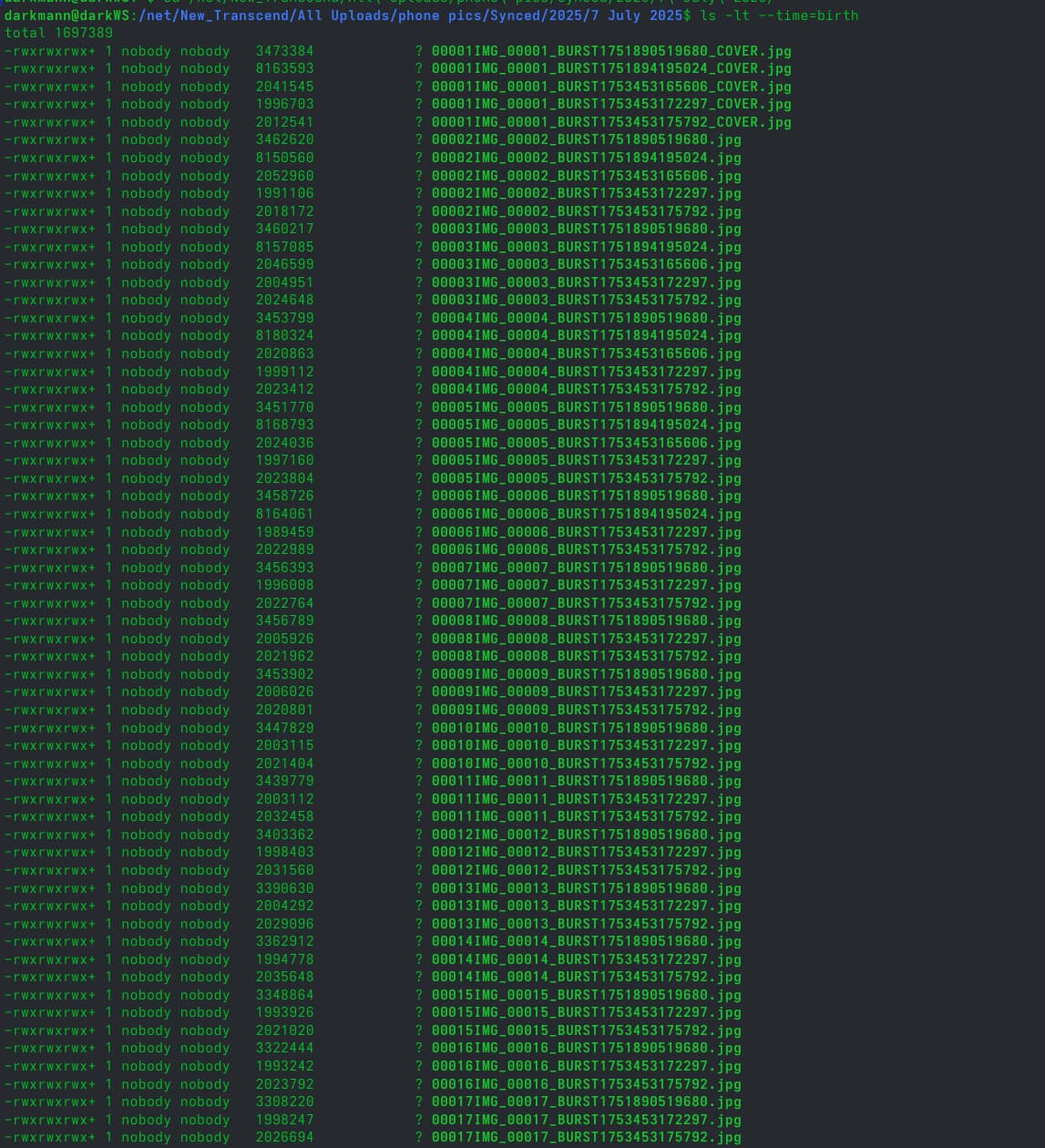

And here is from the SONY a6700:
So I don’t think the origin of the files is the issue - this is pointing towards something FS or share option or protocol related, methinks.

Yes when you use ls ? == no date/time. You’re NFS is sharing SSD’s which are again likely mounted on the host/NFS server to ignore (a|m|c) time to reduce drive wear. Meaning no times for client mounts to sort by.
As a side note ctime is typically not the column file managers sort by when sorting by time. Normally a or m time is what the fm will use…which sucks IMO…heh. Getting ctime normally requires using the stat command.
