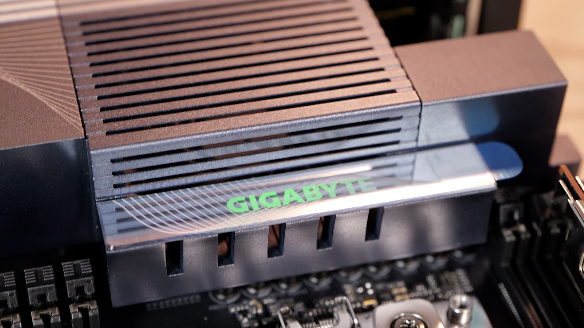

Although this motherboard is labeled as a TRX 50 board, in some ways it’s more suitable to Threadripper Pro than standard Threadripper. It has 8 memory slots but only supports 4 DIMMs on standard Threadripper. The VRM is also suitable for Threadripper Pro; it’s built to handle high power parts. In a way it feels like a WRX 90 board that just so happens to be able to support non-Pro Threadripper CPUs.

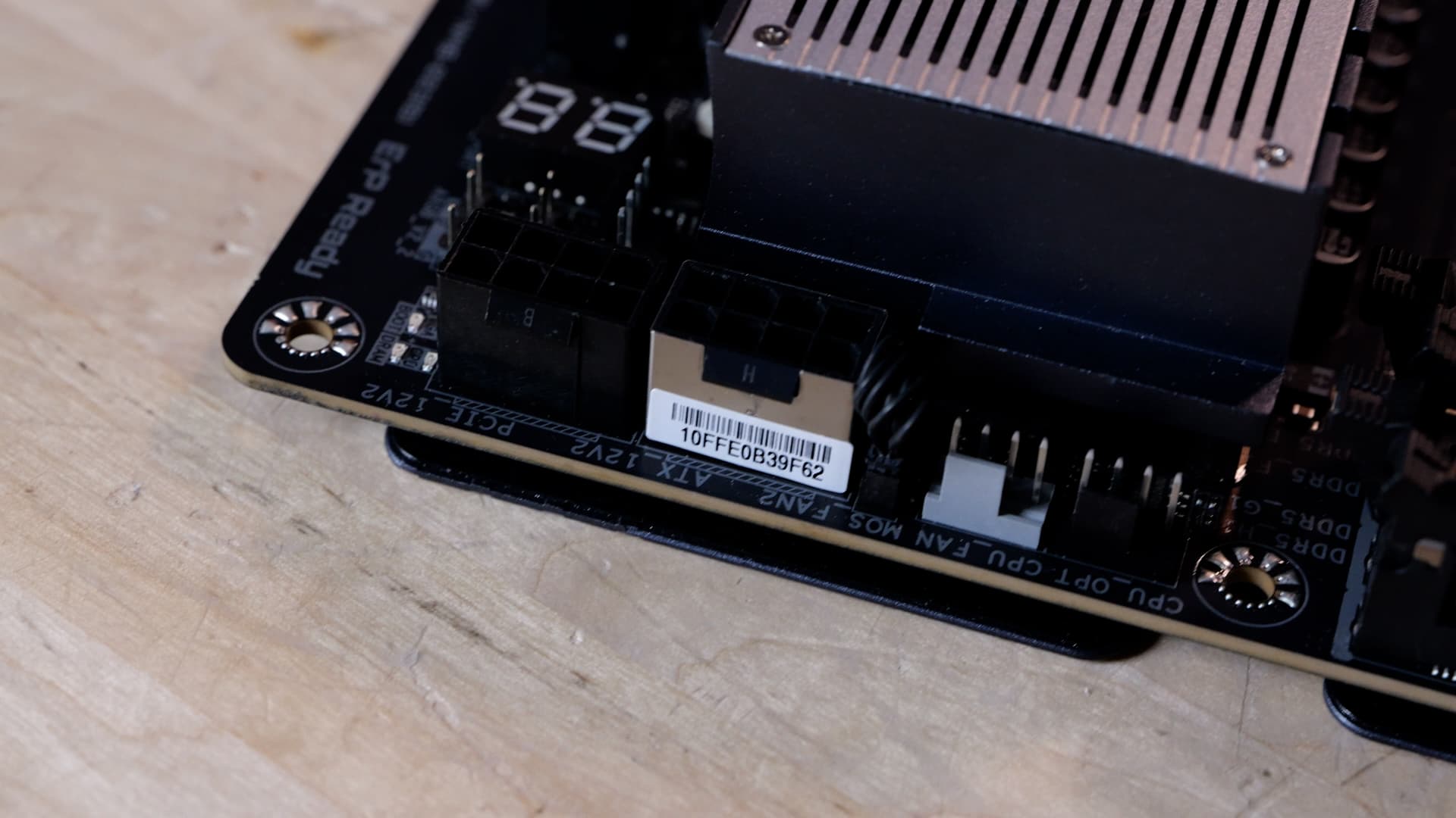

The PCIe layout also is worth considering; there are four x16 slots, but the bottom is only PCIe Gen 5 on Pro CPUs or 9000 series non-Pro CPUs, meaning those of you with 7000 series non-Pro CPUs won’t get Gen 5 speeds. This board seems built to support multiple GPUs, and has two extra GPU style power inputs to help support that. The x16 slots are also fastened to the backplane and reinforced.

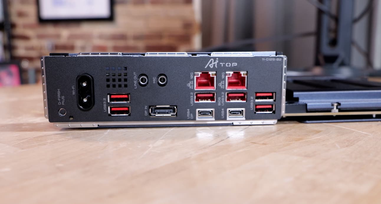

The rear IO is fairly typical, but I want to draw attention to the 10G connections at the back. These are connected to a Marvell 10G chipset and are fastened to the rear heatsink assembly, which has a fan to help with cooling. This assures that it won’t overheat and cause connection loss, or cause a loss of bandwith. This is something that a lot of other TRX 50 and WRX 90 motherboards have not figured out, so good work Gigabyte. There’s also plenty of room for airflow over your DIMMs, which is nice to see.
