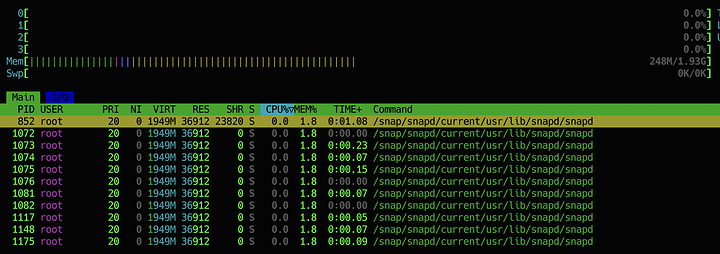

I’ve got Ubuntu Server 25.10 running on a Raspberry Pi 5 with 2 GB. So, maximizing the amount of free RAM is important.
I have no need of the Snap Store on a system I intend to use as a centralized log server, so I’d like to get rid of. Especially since it does seem to be using at least 36.93 MB of RAM at idle.
