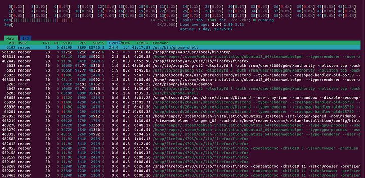

Here is a SS of what htop output currently looks like
I now have some headway on what is causing the freeze up. gnome-shell is maxing out CPU% in htop when this issue begins to really get bad. And it can max out that usage in as little effort as clicking on something in my top bar, such as the steam icon to get its dropdown menu or clicking the dropdown menu for power/sound/network/settings etc. Just by doing this the CPU usage spikes anywhere between 50-100%. There is definitely something happening in gnome-shell that is eating up my resources on the system for extremely simple tasks. This also makes sense as to why the login screen can also be so unresponsive, since gnome-shell is handling this as well. Does gnome-shell also handle the terminal that is the zfs decrypt screen as well? If so it also would make sense as to why entering that key is also rather unresponsive.
