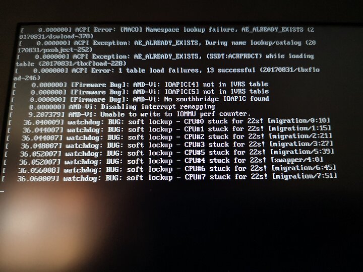

Just got the Acer Nitro 5 and i want to install ubuntu on it and ive gotten no luck. Ubuntu will not boot. The error that i keep getting is WATCHDOG bug cpu hung up. attached an image of it. I have tried different releases of ubuntu 16.04, 17.04, 18.04 and suggested by Wendall on twitter 18.10 and i have added boot flags to grub like nomodeset and nouveau.modeset=0 and it wont work.

Check this thread:
Those flags are still giving me the same issue :frowning:
You may need to turn off ACPI entirely. acpi=off or pci=noacpi as per here:
A Windows based BIOS update might be needed too.
i have already updated it to the latest bios as well
alright alright, i got into ubuntu with nomodeset and acpi=off

What kernel does the beta use? I know ryzen apus like the 2500u are having issues on everything short of 4.18.
Nevermind it’s 4.18. maybe try the 4.19 release candidate?

First time post here on this forum for me. Found this post and wanted to help out
Doing the grub edit from this blog post worked perfectly for me. Currently typing this from my Lubuntu 1804 install.
I had a succsess from this post here: Ryzen/Vega laptop PCIe Bus Error
Open terminal and write sudo nano /etc/default/grub and add processor.max_cstate=1 to GRUB_CMDLINE_LINUX_DEFAULT line so it reads:
GRUB_CMDLINE_LINUX_DEFAULT="quiet splash processor.max_cstate=1"
Then don’t forget to update grub sudo update-grub.
That helped me on my Acer with Ryzen 5 2500U.
