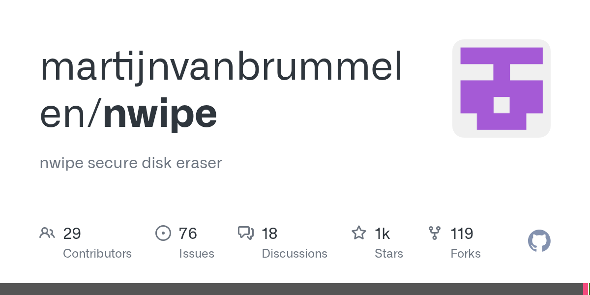

nwipe is the command line equivalent of DBAN for systems where you have trouble booting DBAN. All major Linux distros include it, and failing that you can compile it without too much hassle
