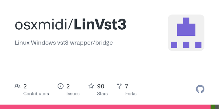

Hmm, may not be compatible (similar issue in a different DAW, but I think it’s the exact same root issue): invalid ELF header errors in Reaper · Issue #13 · osxmidi/LinVst3 · GitHub

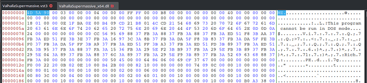

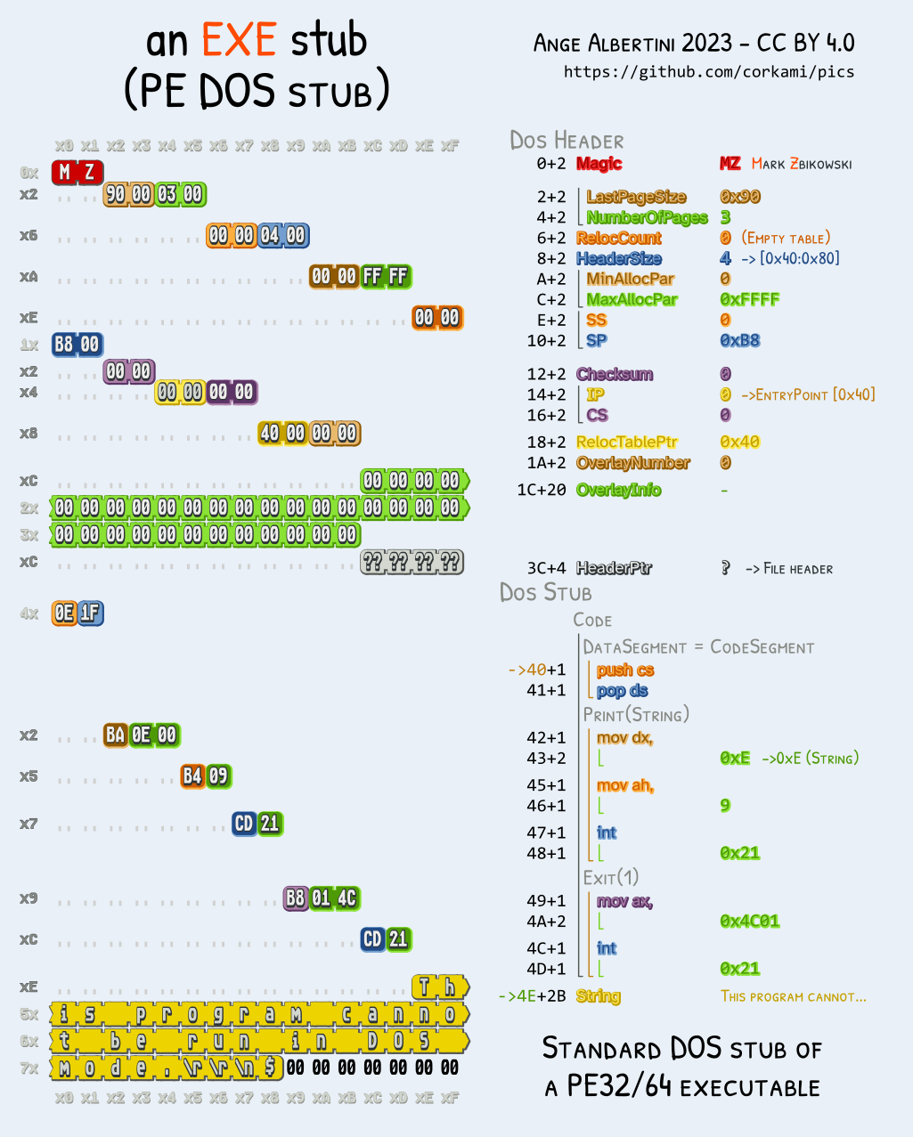

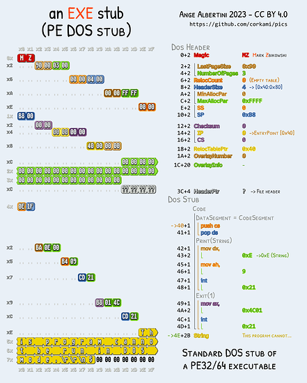

It complains about the ELF header. It fails to find the magic number in the first 4 bytes:
0x7F 'E' 'L' 'F'
Which makes sense because this VST is DOS MZ, not ELF.
But it looks like I can use this bridge wrapper compatibility layer thingy from the issue linked earlier. (I didn’t realize I was looking at the potential solution, I misread initially and thought it was a Reaper only tool.)
It says in the test VST plugins docs that valhalla is supported. Will try setting this up tomorrow…
