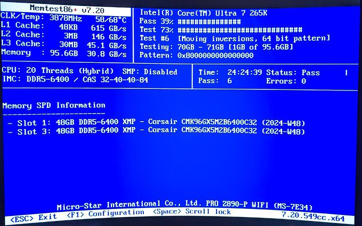

I had a feeling it might be a bad stick of memory so I’ve run memtest overnight but after 3 full test runs everything still passes.

I first let memtest run for about 24 hours and it passed the whole time.

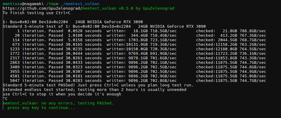

So, then I tried checking the GPU, which was all good.

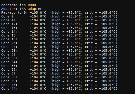

Then I ran a Prime95 CPU stress test and noticed something funky… :stuck_out_tongue:
Screenshot_20250909_203921
So yeah the CPU apparently just shot up to max temp every time it was loaded. I hadn’t checked temps since I put the machine together. After reseating the air cooler and repasting the problem was still there albeit taking a little longer to reach the max temperature.
I’ve now installed a beefy AIO and under load 2 cores reach slightly over 90C in synthetic stress tests while the rest stay below that and everything seems stable for now.
Looks like the CPU was just happily cooking itself and I had no idea. Fingers crossed this solved the issue. Thanks for all your suggestions on what to test! If the problem returns in the near future I’ll add to this post if necessary.
