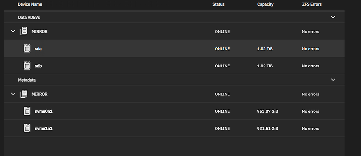

Hello, I wasn’t sure where to put this so here it goes. I watched one of your videos (recommendation from Lawrence systems: ZFS Metadata: Special Device And You!. I just setup a pool in TrueNAS that has a mirror 2TB SDD and then a MIRROR 1TB NVME special. I’m not sure the performance boost I’ll get considering it’s all SSD. I believe I found the option that you mention in your video. I plan to use this pool as a mix of zvols and datasets. The zvols will be for VM storage that I’m running on XCP-ng.

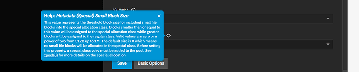

I believe I found the setting that you’re referring too in the video. It looks like it defaults to zero. The big poster is blocking it.

You speed up metadata reads and writes. But a SSD mirror is already pretty good at that.
Leave it at zero. The blue rectangle explains it pretty well.
You could use a PLP SSD as SLOG, if you want faster sync writes.
I think that this makes more sense for cacheless SSDs … using the NVMe for metadata/small blocks. :roll_eyes:

So, if i make this setting above 0 then files that take up blocks that are less than this size will be stored on my special disk.

What do you think my best configuration is for my current setup?
2x nvme 1TB and 2x SSD 2TB. I do plan to do sync writes for my VMs.
Should I do a RAIDZ1 with 1x NVME 1TB 2x SSD 2TB then keep the 1x nvme as a LOG?
I would create 2 pools, one for the system/apps/instances using the NVMe mirror, and another one for data/media/etc using the SSD mirror! :wink:
That’s not possible, you need at least 3 identical disks for raidz1! :roll_eyes:
