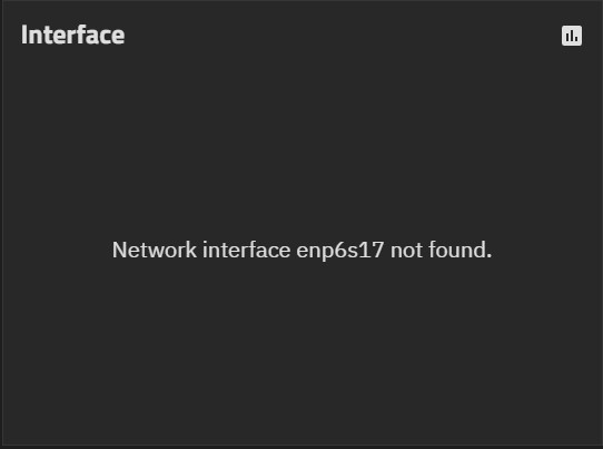

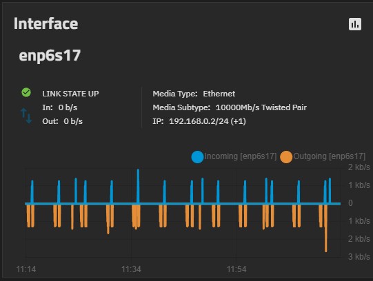

Thanks for all the replies. So revisited Tom’s video and Craft, and was able to create and test a replication with no major problems other than adjusting dataset settings. My only major issue at this point is the 10 gig peer to peer networking. The reason I’m really bent on this, is cause at 1gig the transfers take about 30hours, where as using 10gig takes about 4hrs.
This is the status on the primary bare metal Truenas:
Truenas-1a Baremetal
This is the status on the secondary vm Truenas:
Truenas-2a as a VM
They both show a link to each other through the cards, but Truenas 1 doesn’t see the other card settings.
They are both on the same i.p. address scheme.
Ideas?

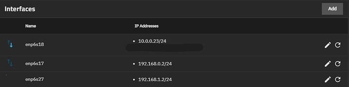

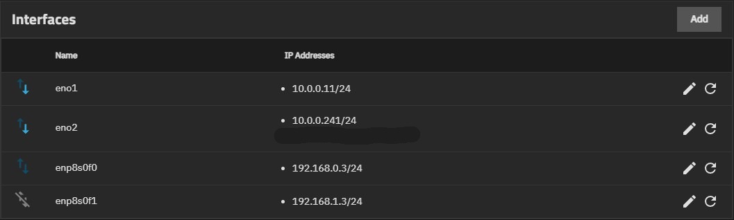

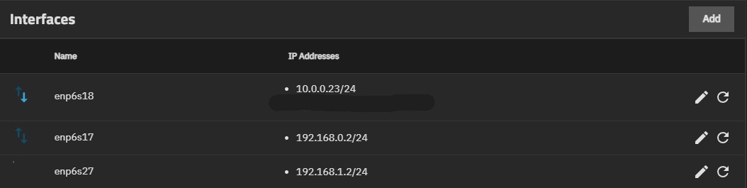

I’m trying to get the 10gig cards on each Truenas to communication peer to peer. As I posted They see each other, but one won’t see the other. One is a Dell X550-T2 and the other is a Silicom X550-T2.
It looks like you are looking for an interface named enp6s17 on TrueNAS 1 (“bare metal”), but there is no such interface on that computer. The interface is something that the local network software is using to communicate with the hardware; it’s not something that is supposed to be visible over the network!
Which IP network are you using for the direct connection? 192.168.0.x/24? If so, TrueNAS 1 should be able to ping TrueNAS 2 at 192.168.0.2 and vice versa. (This assumes that no other NICs use the same 192.168.0.x/24 network since that would mess up your gateways settings.)

The enps6s17 is the one 10gig on the vm Truenas, referenced on the Baremetal which makes no sense if they are connected.
Yes they are using 192.168.0.2 and 3 addresses.
