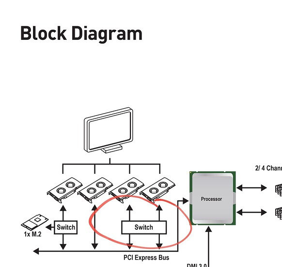

Went through my motherboard manual and found the block diagram, looks like there is in fact a switch in between my CPU and the top two slots. With any luck, that is all that was damaged.
Since the board is still working well enough, I have time to make sure my backups are up to date before I pull it apart.
