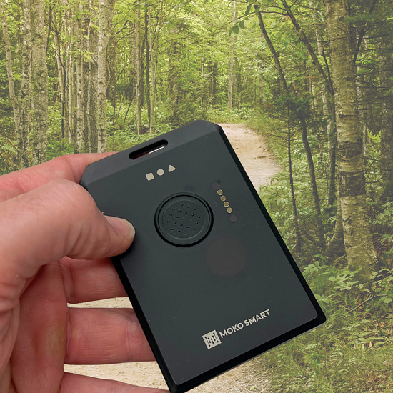

If you want something wearable
Thats a good device or the seed T1000E

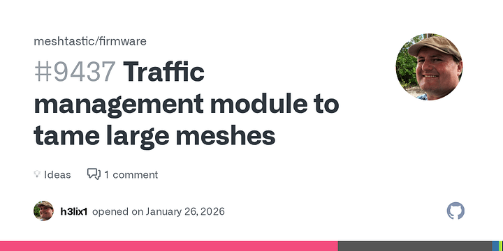

Traffic Management is an interesting idea
