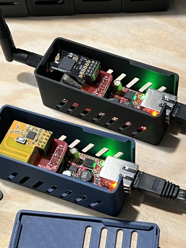

I ended up going with this guys product he builds and have been very happy if you want to stick with PoE:
If it is wired into mains or in the walls I try to stick with zwave as I believe their quality standards are higher and the protocol is more resilient to wireless interference. If it can plug in or is outside the walls then I don’t really care as much. I still try to stick with zigbee/zwave to keep traffic off my WiFi but some stuff requires esphome like mmWave and garage door stuff.

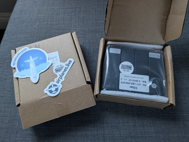

Airframes meshtastic filter batch 14 seems to be shipping out now. Woot.

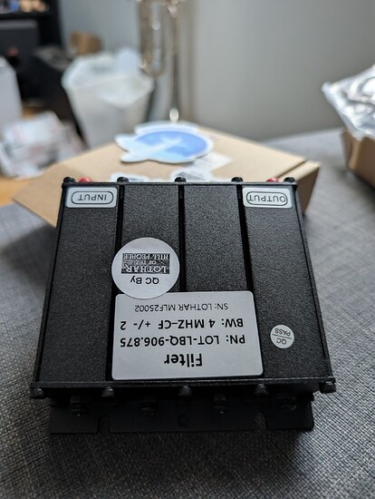

Im just excited these filters are arriving. They are so highly reviewed and i can finally build out my “main” node that will have the most LOS of all my available locations.
These things are heavy. But now finally i can work on enclosure sizing, install and testing

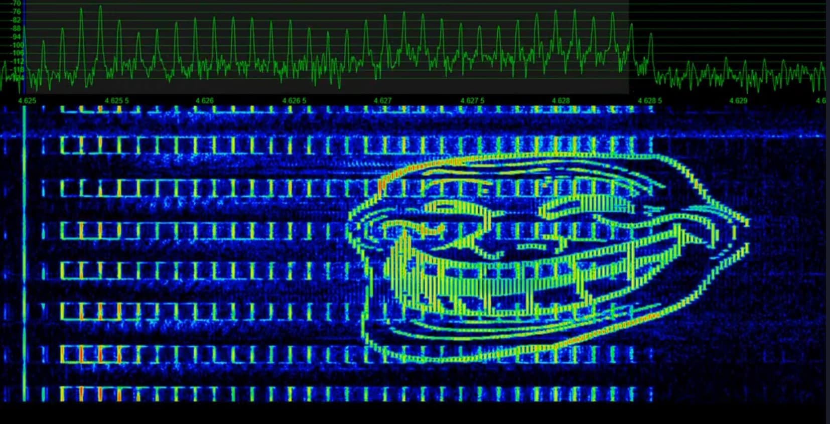

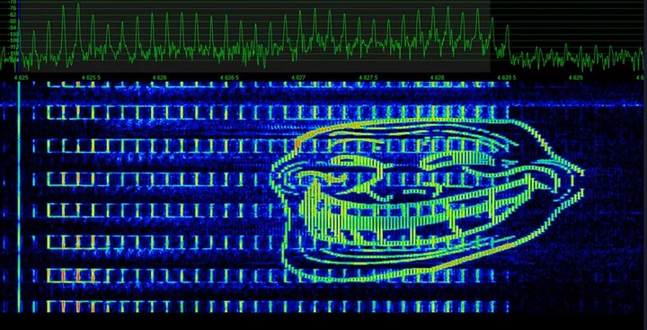

ROFL @Token @THEkitchenSINK @SgtAwesomesauce … your gonna die of laughter. We are cooking up a hilarious easter egg only for our tower mounted infra nodes that have SDRs that can transmit…
We are going to do something identical to this in the ISM band but with the following change
Adding a tone:
Male Voice: Me
“At the tone 0 hours 51 minutes Coordinated Universal Time”
Female Voice (Someone from the hackerspace or my little woman… who knows)
“What follows is a scientific modulation test. For more information visit Freq51.net/onboarding
Just for giggles since we can do it legally under 1 watt LMAO
