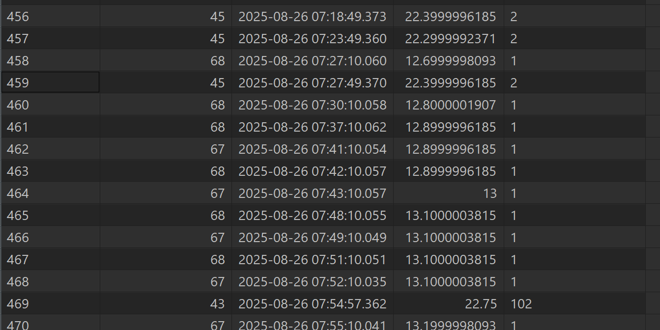

I do wonder how much time it will take for data such as
to grow to the size, where my 256GB m.2 drive won’t be enough (I do have a separate 1tb drive hooked up to that machine, which I use as a storage buffer between my devices).

But I have now looked at the database. I believe I put it online somewhere close to 24 hours ago. Have 1.014 records in the ‘sensor report’ table. And the table size is 160kb. Meaning, at this rate, it will be somewhere near 3mb per month(although I need to create that index for the date field)… and even if it grows in terms of sensors, it still won’t be a problem for today’s average storage capacities.
