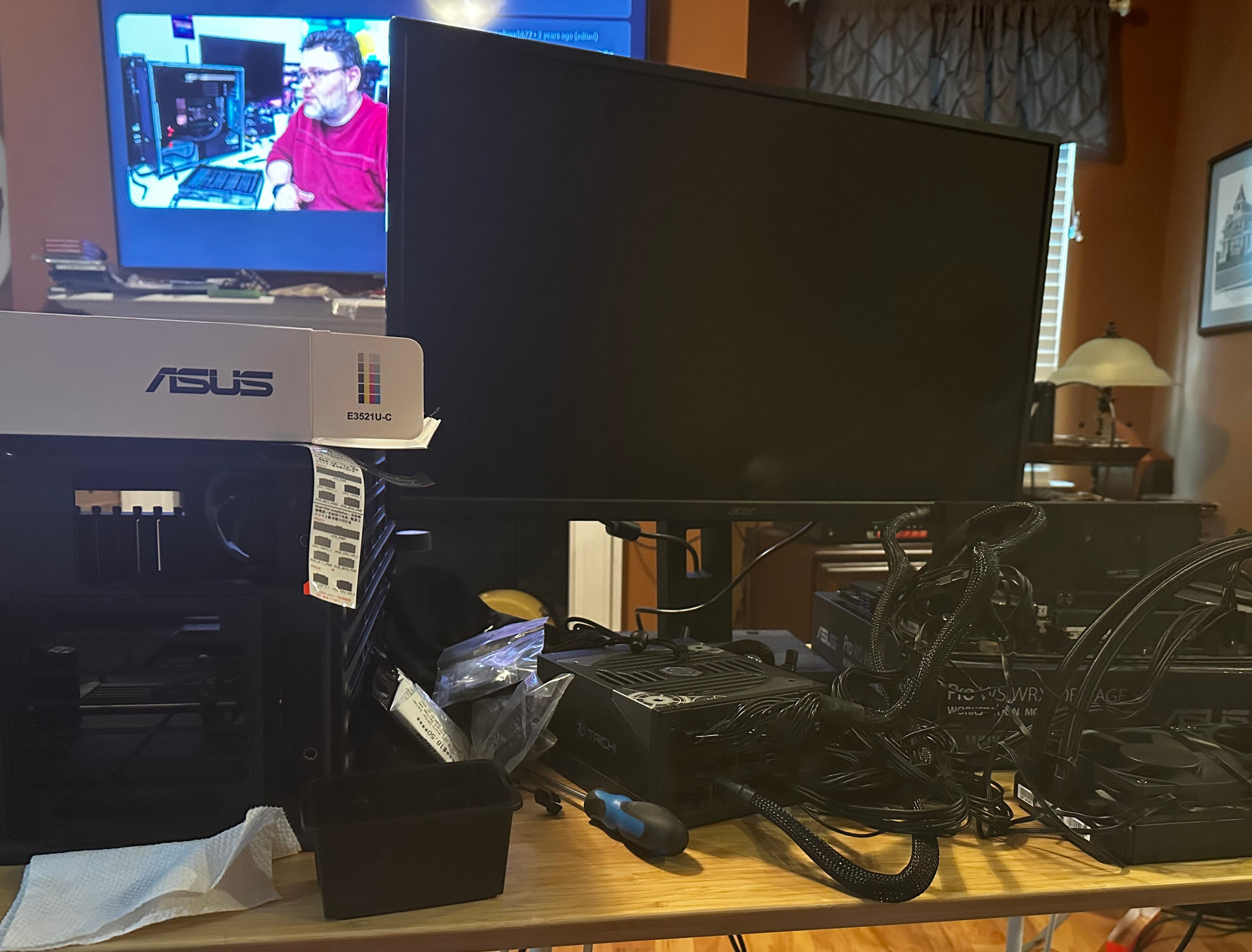

Here is an opening snapshot. notice that there is no case except one that is wonderful but not big enough (HS 420).
Everything is so dark I think I will use another white case.
Parts you may be able to id:
massive ASRock 1650 watt PSU
Silverstone XE360-TR5
ASUS Pro WS WRX90-SAGE SE
128GB (4x32) Kingston Fury DDR5 5600 cl28 ECC
Threadripper Pro 9975WX
ASUS PRO R9700
HAVN HS 420 (not for this build :frowning: )
Custom IKEA table with wheels

OK time to get organized and try for a first boot

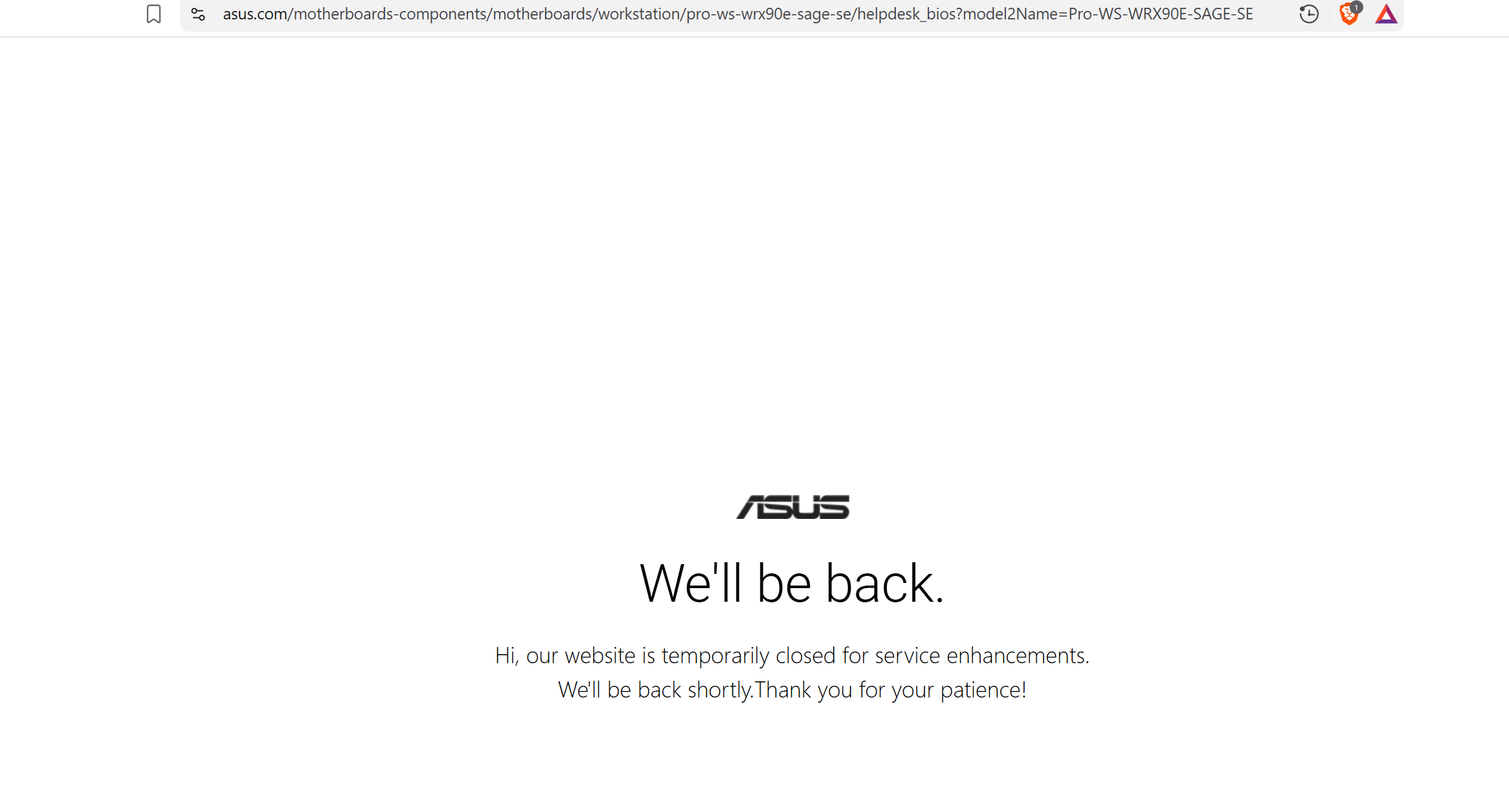

Cant believe ASUS website is down! Trying to get a new BIOS
