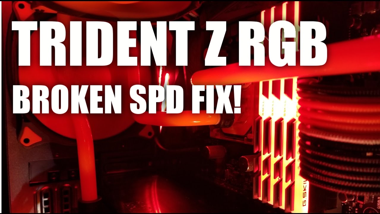

the problems with a ryzen build and the RGB Trident Z memory is that the SM bus used to control rgb LEDs has been flaky and it is corrupting the firmware with all the XMP data ultimately bricking the dimm.
The memory itself is OK and can be recovered but it i a headache. You have to buy a copy of thaipoon burner to reflash the XMP firmware.
Dude if you have knowledge on that throwing up a guide would be awesome for our forums content :slight_smile: i for one would read it
I think that has been corrected. When finally GSkill was convinced that people were not purposely corrupting it themselves.
