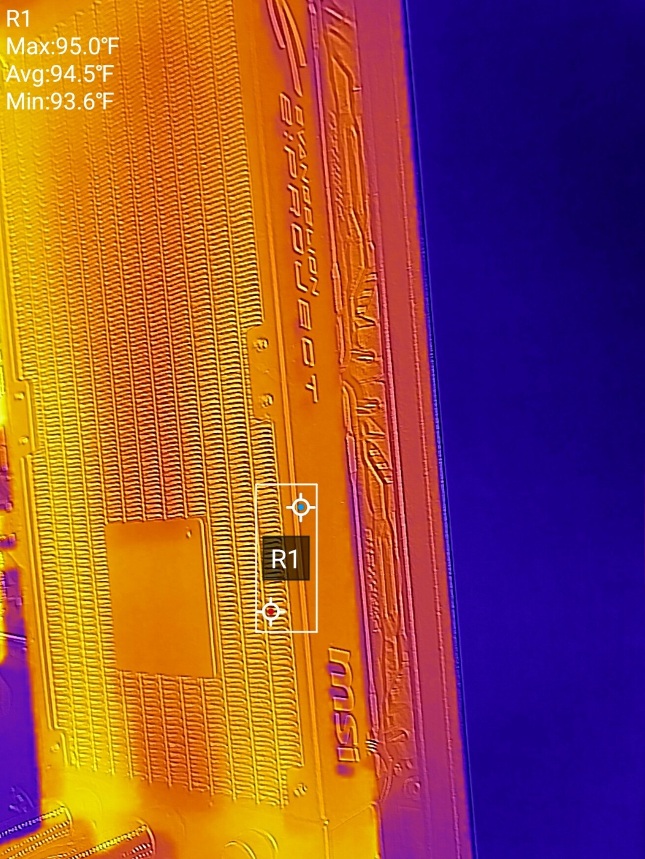

If you’ve got a smartphone with a camera that can do lwir, you can look for channel clogs or a weak pump with it.
Striations in temperature like these under a steady state load would be a give away of the problem:
