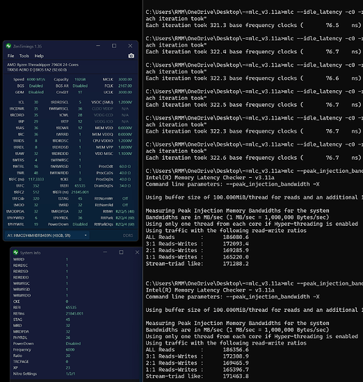

I have 192G of below 1Rx4 Hynix OEM memory rated at 6400. But the best speed I get get is 6000, I tried everything trust me, it will refuse to post above that but be totally rock stable at 6000. Has anyone been able to run 1Rx4 48G RDIMM above 6000 speed, or any 1Rx4 RDIMM for that matter my hope is that TR9000 may be able to run faster, I may need to go to a more conventional 2Rx8 RDIMM to get higher then 6000? The reason was that for the money these OEM DDR6000 1Rx4 48 G DIMM were the best value.
FYI thermal is not an issue as I am running them water-cooled, they are under 50 deg C even at 1.435V.
Note that the timings on these are actually really good, and latency is also good 76ns in MLC and also BW at 185G/s is like the best I have ever seen for DDR6000, only weird timing is tWRWRSCL is high at 36, but all the others are in with the best A-Die parts.
PN: HMCGY4MHBRB489N AA
IC PN: H5CGD4MHBO

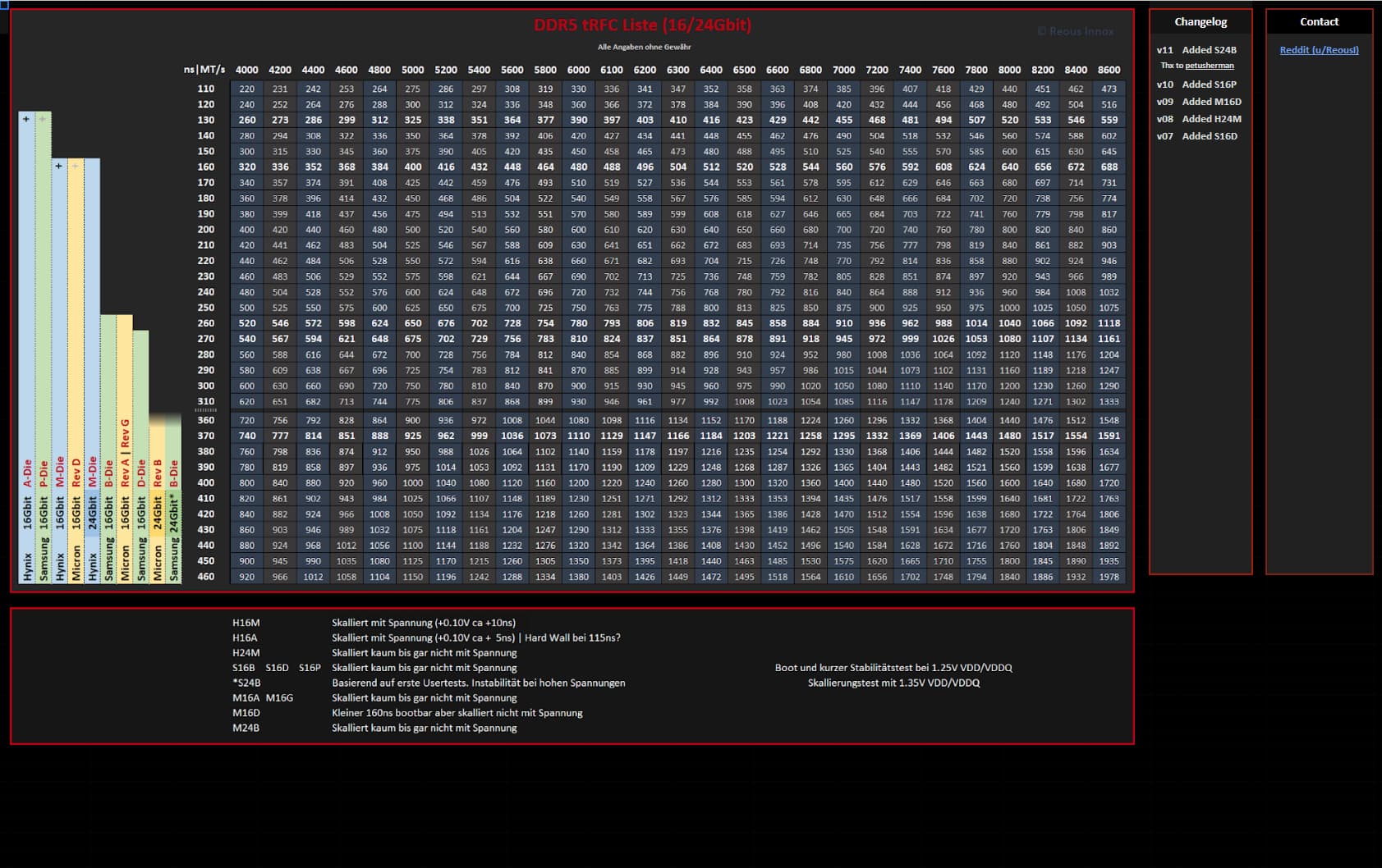

tRFC seems too low:

I did try to run them at stock lose timing as well and they just will not post. Even tried loser then JEDEC. I also tried some conventional DDR 5600 2rx8 32G Hynix OEM sticks and they will happily run at 6600mhz, so I know the HW can do it.

I posted very well tuned setting, to show they they can actually run impressively low timing, with some oddities like WRSCL at 36. Also to prove they are 1r you can see all the dual rank timing set to 1, if they were 2r then that would not post. Been running these timing for about 5 months and they are rock stable, TR is great, as long as it posts it seems the system just never crashes.
tRFC is very low, about 50 lower then any A/M die I have run. 320 is stable for about 24h, but it was so low I was afraid to run it so I just set it to 352 so no need to worry about it. I guess these IC may be new.
FYI got a new CPU 9970X and the RAM can run at 7200 CL38-42-38-42, and I can get about 220G/s read, and about 88ns in Intel MLC, and about 80ns in ADIA. So this odd ball 1r4 192G setup can do decent speeds on 9000 CPU. Needed to run lower voltage on SOC 0.95V (auto), as well as VDDIO 1.1 V (auto) VDDP 0.925V (auto) to run above 6400 FYI.
