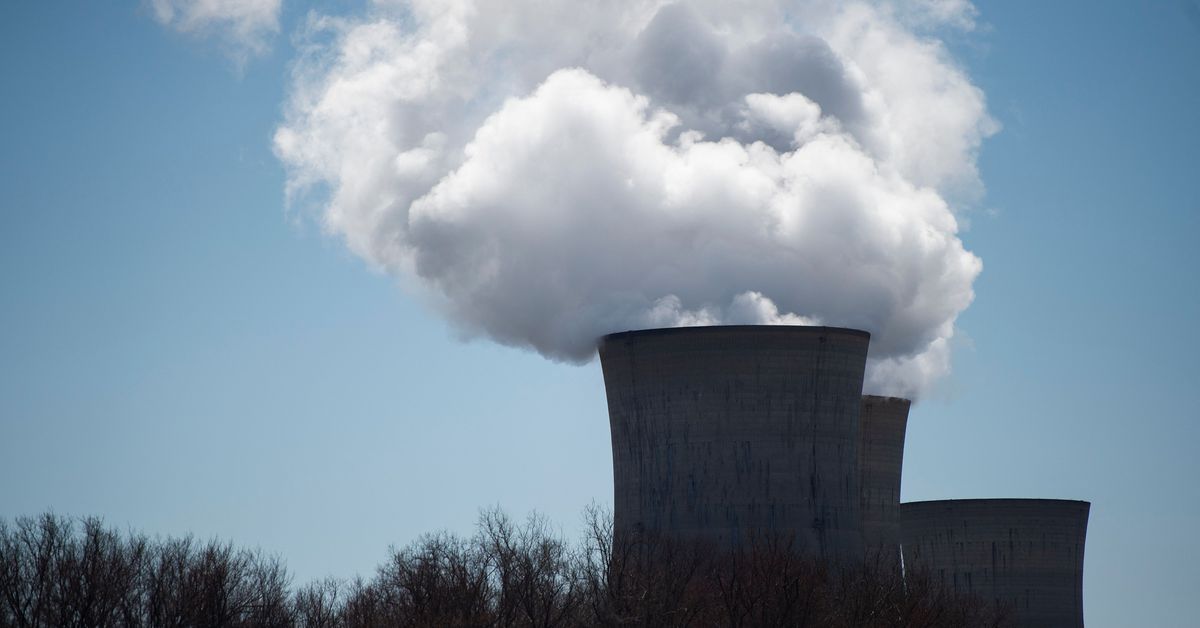

Want 24/7 clean energy to your data center? Go nuclear or go home.
Oracle as well…
https://www.modernpowersystems.com/news/data-centre-powered-by-three-smrs-to-be-built/.
