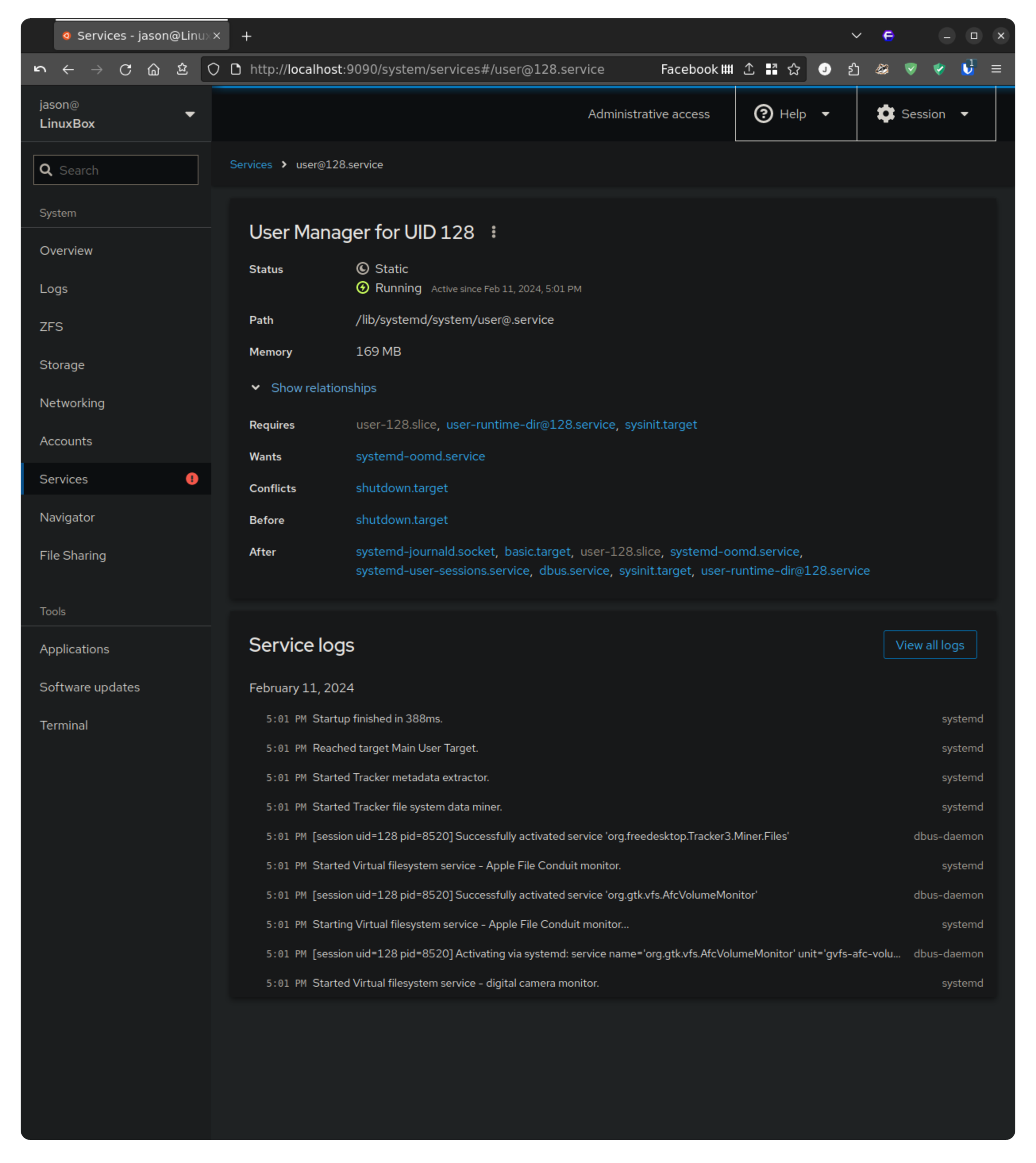

This Service fails to start on every start of my system
I will include a screenshot of the page in Cockpit that shows some info about it. What is this? If it’s necessary, how can I go about troubleshooting this? If it’s bad, then what does that mean for my system?

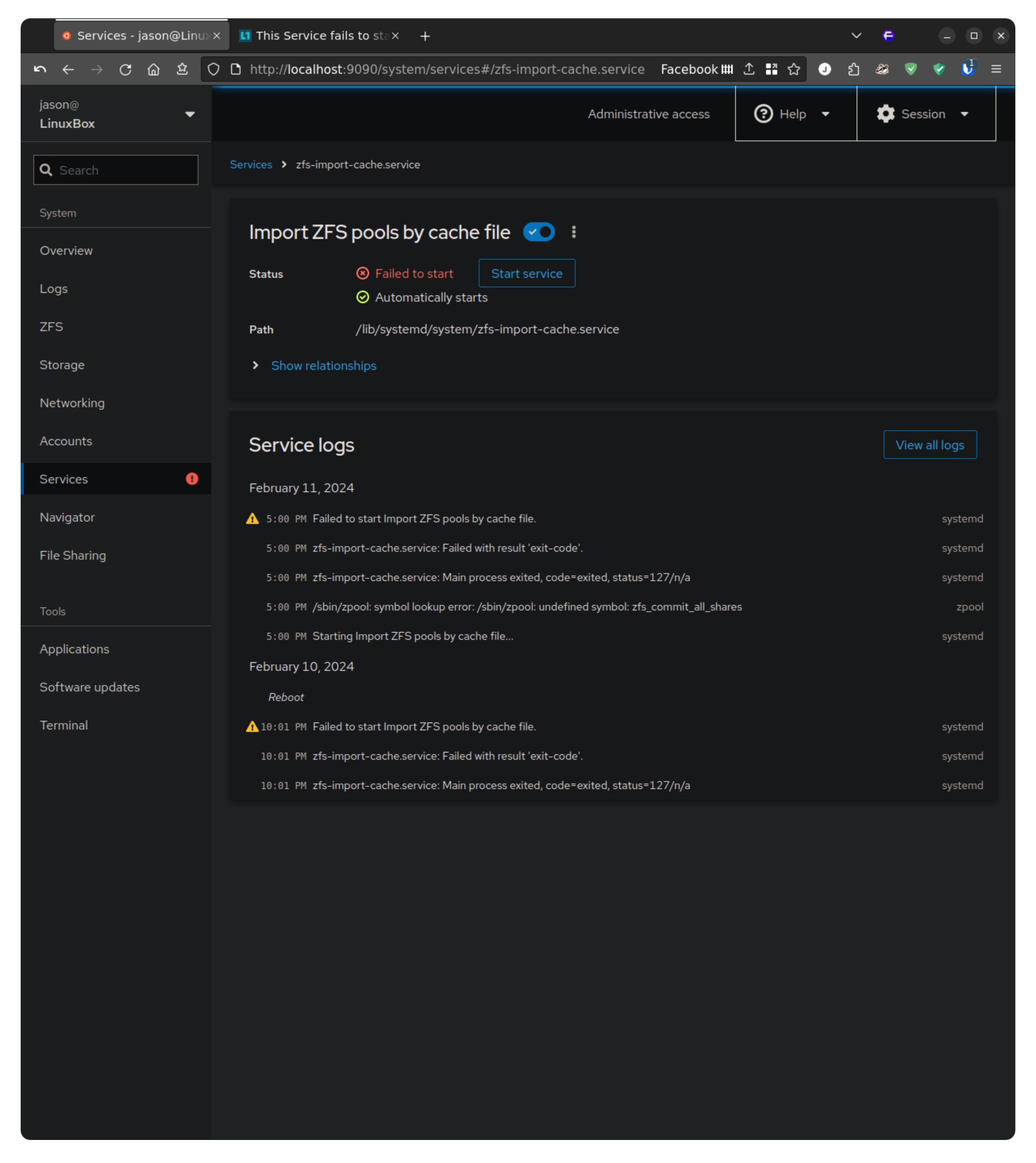

If it’s related, here are the two ZFS services that also fail to start, forcing me to manually import the ZFS pool on every reboot.
And they won’t for a version almost 2 yrs old. Go update Ubuntu first, reboot and see if these fixes are applied. I bet they will :stuck_out_tongue:

I solved this issue, that inadvertently solved another issue, by getting rid of the ZFS I built, and building it via the instructions on the OpenZFS website here: Custom Packages — OpenZFS documentation
for a KMOD native deb build.
