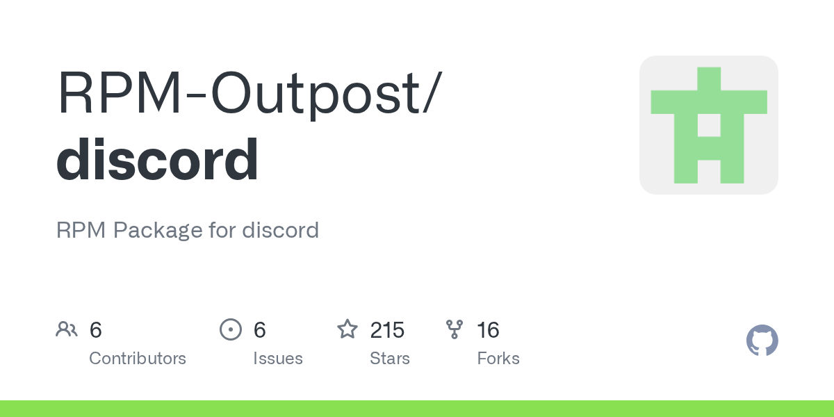

Sorry if it has already been posted (I’m a bit behind in this thread) but I gave this a shot on my F26 machine. Worked straight out of the box. It even has the option to install the canary build.
Thanks, but I’ve since abandoned Fedora due to dracut issues.
