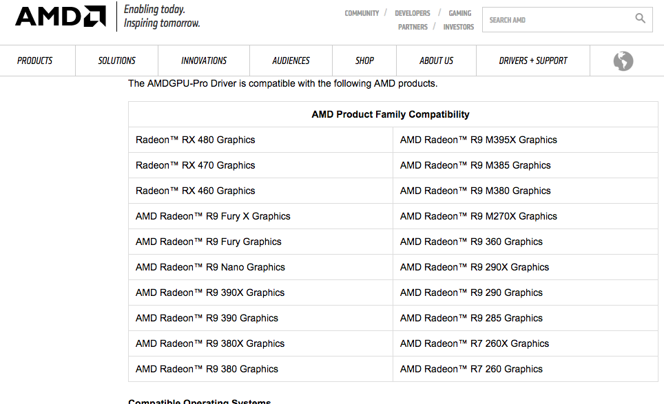

So it looks like the AMDGPU-PRO driver really is not compatible with my card as the AMD Website stated. Hopefully they will increase compatibility across the range asap.
The full driver is supposed to support everything up to a couple of generations behind....Now ETA is anybody´s guess.

Still need to get AMDGPU working on 370 ;A; AMD PREEZ!!
Im pretty sure amd recently released initial gcn 1.0 support for amdgpu though I dont know how to activate it
Just an update: Literally everything but the 370 is supported in AMDGPU-PRO according to the AMD site.
So will older cards be supported? I have HD 7770, it's GCN, I believe, so they should support it, right?
You might be cutting it close, mt laptop has a 7670M and it isn't GCN
Well, it does support Vulkan on windows, I believe. Also the AMDGPU driver works out of the box.
A 7770 is just a 250/60 isn't it? I'm pretty sure its fine.
I do not see the 270 either. But the 270X is just a buffed up version of the 270. It might actually work for them as well.
