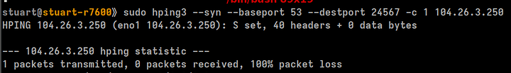

sudo hping3 --syn --baseport 53 --destport 24567 -c 1 104.26.3.250
…but I always get 100% packet loss as shown below:
Is my test incorrect? Is there some other command I should be running? Or is this just a blip on Worldpay’s side, which may or may not be related to the fact that they are using Cloudflare’s IP?
