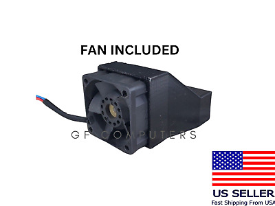

Interesting take. The conclusion I drew from these fans was that these don’t have enough cfm. According to ChatGPT, 1 watt can be disappated with 1 cfm. I don’t know if this is true but it was the only way for me to get some kind of idea of how much cfm you actually need. Based on that I used this adapter.
Along with a high speed (loud) 60mm fan it does stay cool. You can even add an adapter from 60mm to 80mm to try to combat the noise.

I had a couple P4s. I used this to cool them,
Worked pretty good, average temps in the 40-50c range.
