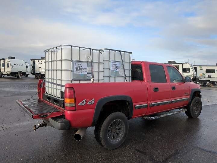

Picked up two 275 gallon food grade IBC totes for $40 each. Might need these temporarily, and they were cheap.

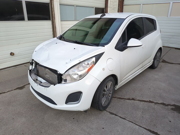

Picked up a wrecked 2015 Chevy Spark EV for $1760 which has a 19kw battery in it. The cells are large so there will be fewer cells to balance and they run typical Li-ion voltage range which should be 3 to 4.3v (need to confirm these numbers).
This should be about $6k worth of batteries.

I was reading the OP and was about to ask how you got so much capacity for under 2k. Nice find! :smiley:
I couldn’t believe the post was already a week old when I found it. This thing even drives perfectly fine, but he was asking $2,700, I intended to offer 2k flat, but the banks were closed and that is all I could round up out of the ATMs, to my surprise he took it. Sweet! Lol
Realistically this battery will be down on capacity, but I haven’t figured that out yet. I expect to be down %20.
Still dude, these days, we’ll be lucky to get 5kwh new for $2k.
So hell, call it 25% down and it’s still a steal.

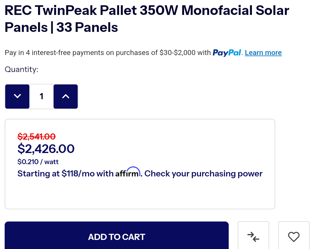

But TBH I don’t think it matters anymore since solar is 25¢ a watt. I’m eyeing some panels for 21¢ a watt.
That’s a damn good cost. I just like having the diversified power sources, ya know? Where I’m at right now, it’s got some serious cloud cover from april till end of june, and it’s not realistic to rely on solar 100% of the time.
I had no idea that solar was so cheap now.
I’ll have a generator for backup. Obviously not ideal, but what ya going to do ¯_(ツ)_/¯
It’ll still cost me way less than rent.
That also have bifacial panels which generate power from both sides and those perform much better with cloud cover and snow.
There’s also panels that can deel with parts of the panel being shaded which is really cool tech too.
And you’d think all this sounds expensive, but it’s all shocking cheap. 33¢ is on the higher end for the distributors I’m looking at. I don’t want to drop any names or links, but a simple search and you’ll find a few options.
I don’t really think it’s terribly expensive. Remember, I pay $0.26/kwh overnight rates for electricity, so on just the panels, it’s like a 1 year payback period. Add in all the energy storage and power conversion equipment and it’s more like 4-5, but still, at the end of the day, that’s a really good ROI. Especially if the local utility is asking some crazy fee to tie you into the grid.
