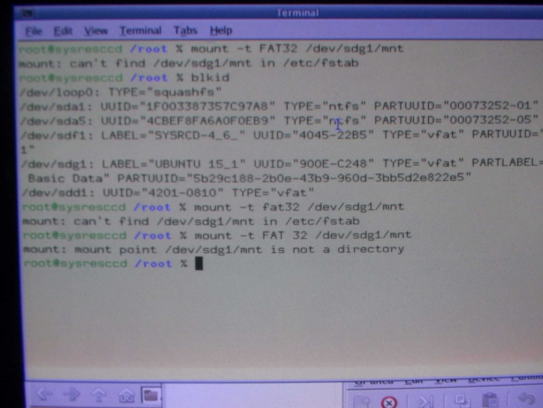

however plugging in a flash drive doesn't seem to work as I can see it in Gparted, but can't find a way to move data to the drive

You will need to mount the disk somewhere. try mount -t type /dev/sdxx /mnt where type is the format of the disk (ntfs, fat32, ext4 etc.) and sdxx is the device and partition (sdb1 etc.) You can run blkid to see a list of available block devices to find what your device is called.
This will mount it to /mnt but you can mount it anywhere you like, just create a directory somewhere and use that as the mount point.
Well that's where I'm at, the drive UBUNTU 15_1 is there according to the Gparted window just off the screen
you need a space between /dev/sdg1 and /mnt. They are seperate arguments. Also I think FAT 32 should be vfat or fat32 or something with no spaces.
well doing
mount -t vfat /dev/sdg1 /mnt
just bumped it to the next line with no errors, though I still can't see the drive mounted anywhere in the file manager
it will be at /mnt
and it worked, thanks, if only google told me this 3 hours ago
