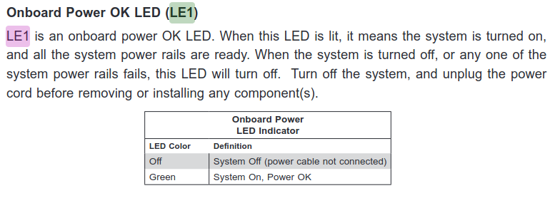

I have a Supermicro H12SSL-i. It has been working for 6 months. Now when I connected it to power the LE1 led is blinking once every second.
This is weird since the manual (https://www.supermicro.com/manuals/motherboard/EPYC7000/MNL-2314.pdf) indicated that only two states are possible on or off. No mention of any blinking for LE1.

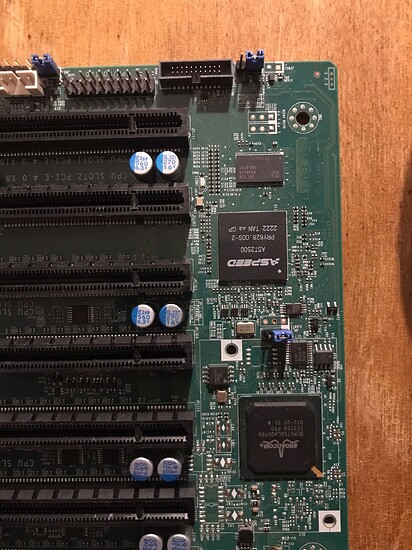

You could help us help you by posting pictures of the board and those ICs around the BMC, socket and between the pcie slots.
On newer revisions, SM moved those regulators to the back of the board.
Thank you for the reply. I will start going over the thread above.
I removed the motherboard from an old case (where it was working) to the table. The revision is “REV: 1.02” indicated by the text under Supermicro-logo.
Below is an image of the IC’s around BMC light:

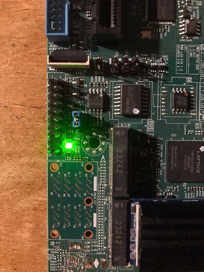

and this is an image around LE1 (blinking):

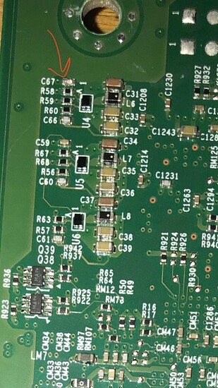

Here is a picture of the backside of the motherboard under AST2500.
C67 (Bare-Silicon-Die 6 ball BGA DC-DC Voltage-Regulator?) is a bit scratched and like said it is the most probable cause for this problem.
I’ll do some measurements when I can to confirm this but as for now I think the case is closed. Is there any chance it could be replaced fairly easily?
Seems like you got the newer revision with them on the back then.
The DC-DC converters are U4, U5 and U6.
Tiny silver squares.
C lettering usually indicates it being a Capacitor.
That C67 looks damaged is not that god, but not that deadly either.

LE1 blinking and then stopping would mean that the board is at least receiving the standby power correctly and is able to verify the Bios and FW to be correct.
So not outright dead.
