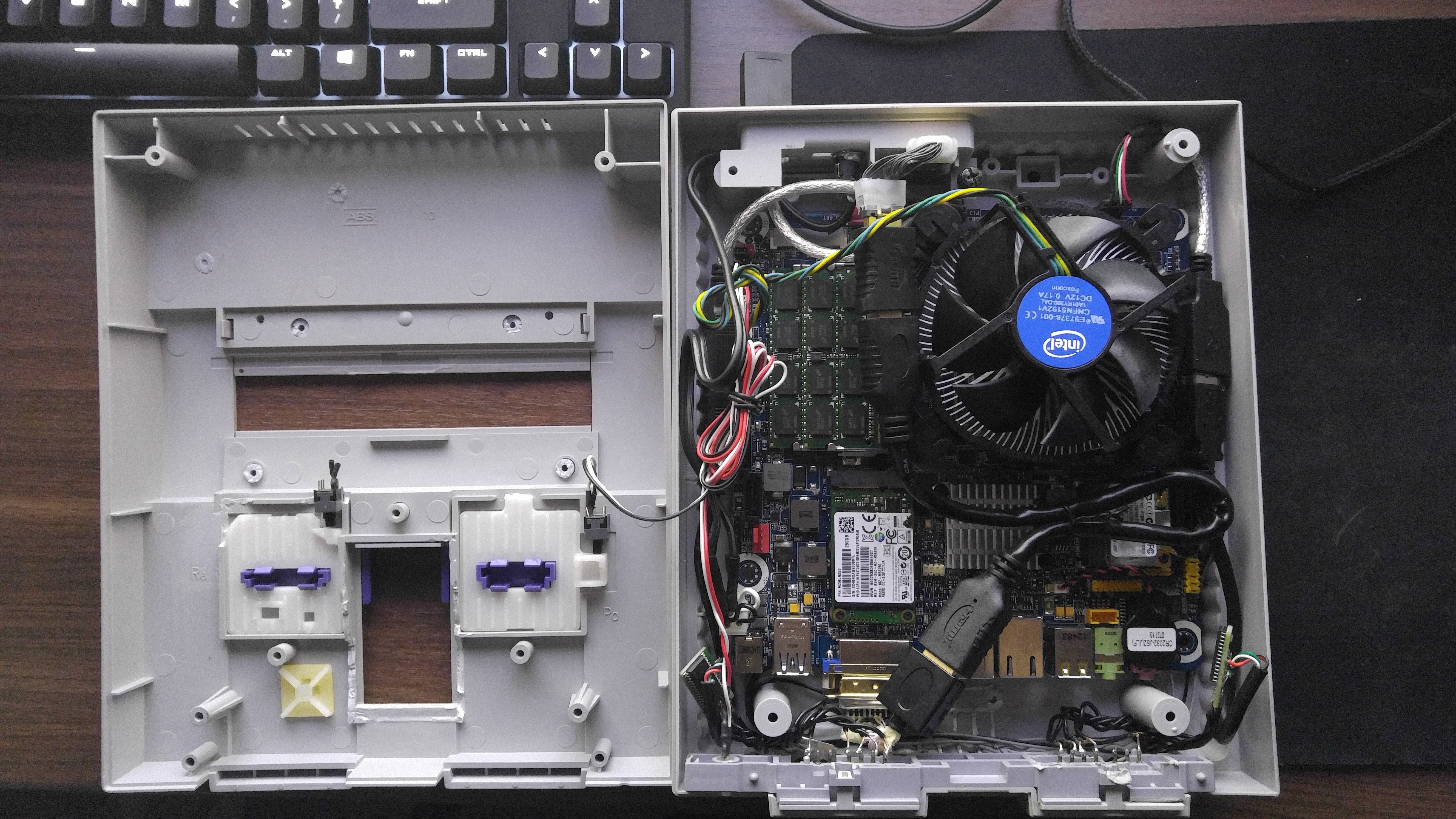

New layout and stuff

The intel stock cooler actually does a better job cooling the whole system
temps stay around 60c and never rise above 70c where with the other low profile cooler it would reach 100c and keep climbing the longer you have the system running.
This new layout gives me more work and cable management room. I have 3 things on my list of things to do.
