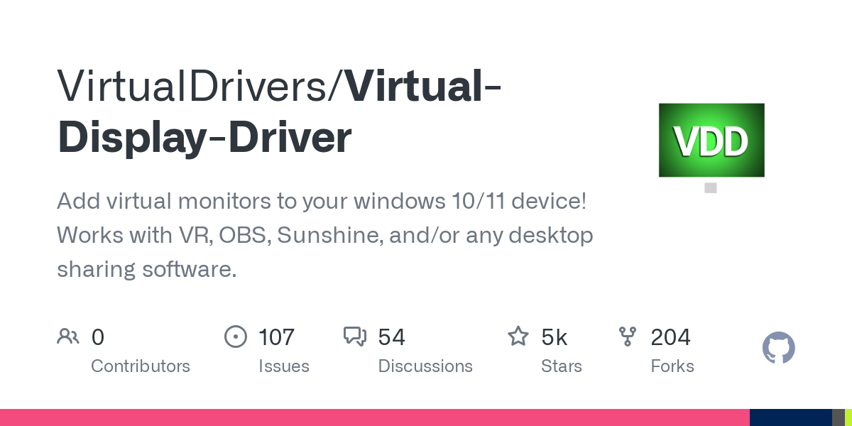

The two nice things I liked about Parsec were the Virtual Display Driver support (no dummy plug needed) and the remote access to the server outside my apartment.
